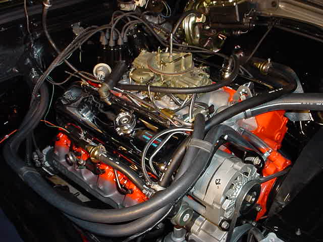

Scott,
Just about everything for these cars are available aftermarket from places like Year One. I get some of my non reproduced decals from Levon Hovaginian in Canada. He reproduces the wiring harness, door tag and others and his work has been flawless. I have had almost every ink stamp from carburators to tire stamps made and some decals reproduced by Dennis Cumby and they are for the most part exact copies taken off original cars. Several can be seen in this shot.
As the LS6 registry gets off the ground and if Greg Carlson can get a web page started, I may list all the different decals and stamps as well as the locations depending on plants and will be complete with photographs of survivors as well as original cars. The response to this has been overwhelming by people so far and will take some time to organize and authenticate. I have been working on this for 4 years so far. All the more reason why we need to hear from more LS6 owners so that we can obtain a more complete photo documention of these cars that can be shared.
Rick

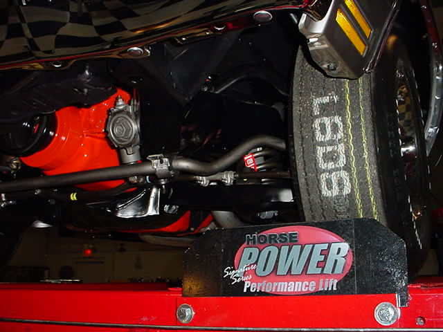

Tire stamps made with help from Rick Peters and Dennis Cumby.

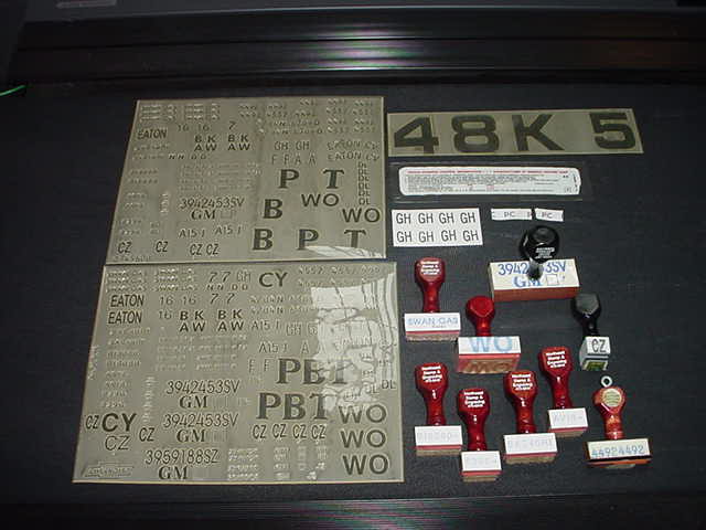

A very small selection made with help from Dennis Cumby and Chris White.

beautiful engine shot! How do you keep that paint on the exhaust manifolds? I'll bet that engine is'nt started much? [img]/ubbthreads/images/graemlins/biggthumpup.gif[/img]

Rick N....that engine looks familiar! [img]/ubbthreads/images/graemlins/blush.gif[/img]

I do not want to speak for Dennis but I also don't want to see Dennis getting all kinds of requests for stamps as he stuck his neck out and made these for me at his office. He did a huge favor for me and I just wanted to give credit were credit was due. As soon as I get everything together, I fully intend to offer this as another facet of my restoration business. I have stamped several peoples parts for them already but I am currently seeking out a better type of ink, hopefully epoxy and also trying to locate several correct colors. The inks I have used so far are not durable and smudge very easily. As soon as I can, I would like to put together a complete detail kit for the '70 Chevelle to start with. I would rather have parts sent to me vs sending the stamps out as they often don't come back or come back in bad shape. However, tire stamps are a different situation obviously.

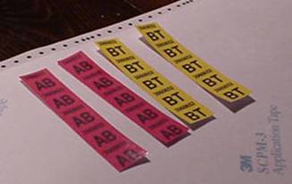

I've actually started to make my own decals as well. I started with the Spring Decals and have now moved on to others like shocks, backing plates, sway bars, frame, throttle cable, brake booster, etc which should be all formatted in a couple of weeks or so. The attached picture shows the spring decals for my car which are not ones that are being reproduced. Fellow Chevelle enthusiast Brian McGuinness sent me all the GM Service Bulletins relative to springs and I believe there are about 21 different 1969 decals based on options and car weight. I think only about 6 are available through the parts places. To be honest I just have a lot of fun playing with this stuff [img]/ubbthreads/images/graemlins/smile.gif[/img]
