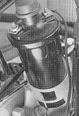

Does anyone know what the correct Delco-Remy coil is for a 1969 COPO Camaro? I always thought it was a #293, but was recently told it should be a #429B-R. Any help would be greatly appreciated.

In the October 1991 Muscle Car Classics there is a restored COPO Chevelle chassis article. The coil in that picture is a 429 B-R.

This old post didn't get much action. I'm not sure if the 293 B-R coil that I have is the original for our COPO Chevelle. I used a Delco transistor ignition on the car for a while and switched coils back and forth. What are the other COPO cars using. The numbers and letters are embossed in the side of the coil.

There was a #429 on e-bay the other day, the fellow said that the #429 was for the Automatic cars and the #293 was for the 4 speed. I don't know what the difference would be? I think there is a #429 on Kevin Hand's Chevelle and that is an auto.

My car(69 Yenko Camaro) has a 293 B-R and I'm pretty sure it's the original.

You might be onto something with the two coil numbers. The Chevelle mentioned above was also an automatic car with the 429B-R coil. Anyone know why the coils would be different? The coil that I have is the 293B-R and the car is a 4 speed.

I have my doubts on the #429 coil being correct for a COPO Chevelle. The restored COPO Chevelle chassis article Keith mentions did show a 429 B-R coil but they just restored what they found on the car and assumed it was original because the car was low miles original condition. They did a nice job on the resto but there were other parts on that chassis that I don't think were original. I would think that the COPO Chevelle would use same coil as 375hp cars but I am not 100 percent sure.
There are two members here who own low mile original Yenko Chevelles. Both Le Mans blue, one auto in MO., one 4sp.in MN. If they read this or if someone has contact with them maybe the coil numbers in these cars can be checked? I would like to know the answer as well as a few others here.

Though certainly not gospel, anyone who has the Sun Service sheets also lists the coils on them. I believe the Mpls Yenko has the 293 coil but I am going by memory. Chad and I discussed this very thing when the car was first purchased but it's all a blur now. I also do not believe there is any difference to transmissions denoting which coil. At least I have not seen this on any documents.
