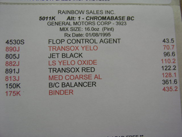

Anyone have the code for Burnished Brown??..my local paint distributor cannot find it and I have no sample to go by..getting ready

Code 61 PPG Car Color List 1969 Burnished Brown Poly

Jed, I need the mixing code..we cannot find it

Burnished Brown metallic went by either one of these:
*R-M #A-2104
*Ditzler #2081
*Lucite #5011L
*Fisher Master #3923
*Cowl Tag Code on Special ordered #927-99334

Albert, I have the Spies formula on file at the shop. If that helps I'd be glad to Fax it over next week. Don

Don, that would be great..but perhaps in a e-mail?? I dont have a fax machine ..thanks for everyones responses..I hope I made the right choice

I have a can of it that I can take a pic of the formula and email when I get back in town.
