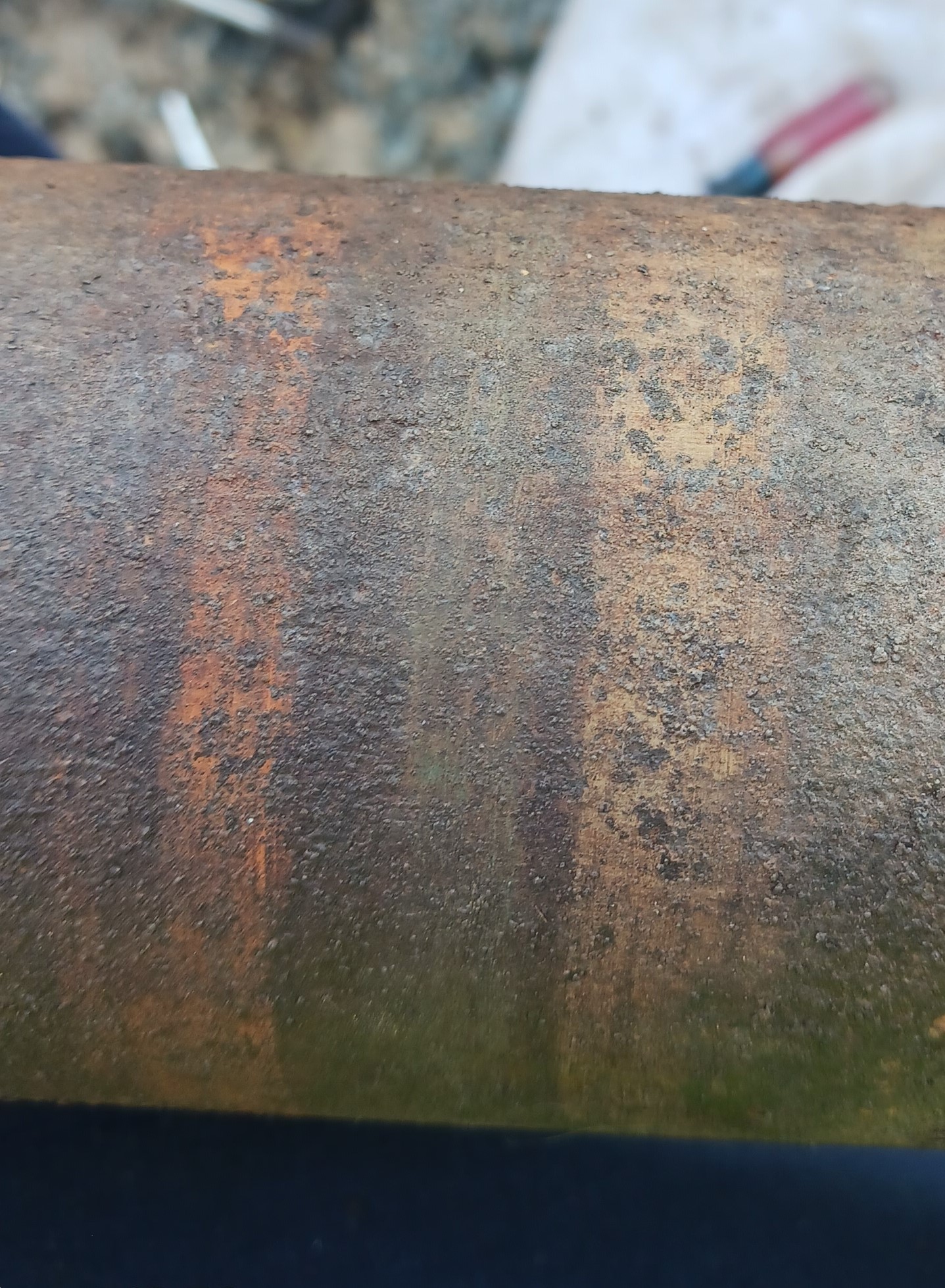

Legit? https://bringatrailer.com/listing/19...mpaign_2648441
I know the rear springs are not original. Always a red flag to me.
Attachments - The Supercar Registry rotoryellow.jpg obpbdate bluepaint.jpg obdriveshaftstripes.jpg obdist2.jpg

I think the pad is OK.
Was the axle rusty and they smoothed it around the axle stamp?

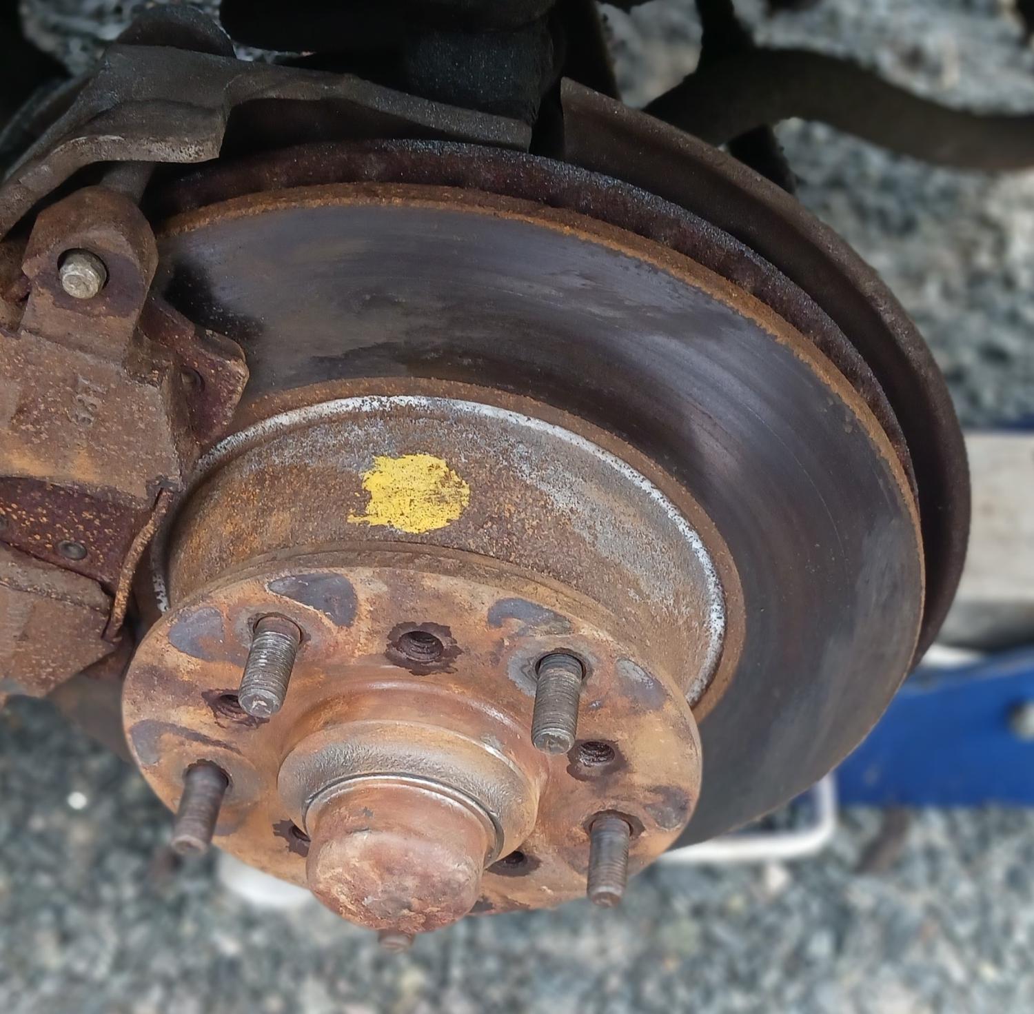

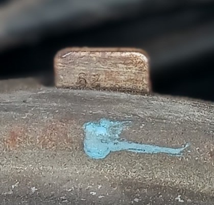

No opinion on stamp for lack of study.
Looks like someone spent a lot of time on the car .
Tag on tranny is for sure rusty.
309 master cylinder is a re-pop.
Just completed the "309" marathon with plenty studying.
Looks to be plenty other re-pop stuff on car.
Driveshaft strips are nice and neat.
Factory driveshaft stripes [well on "OLE BLUE" anyway] are very sloppy. Obviously done with a brush.
Other paint markings are very sloppy also.
A few example's

stampings look good. As mentioned repop springs and other items.
Rear axle tube looks like it was possibly skimmed with filler around the stamping due to pitting.
