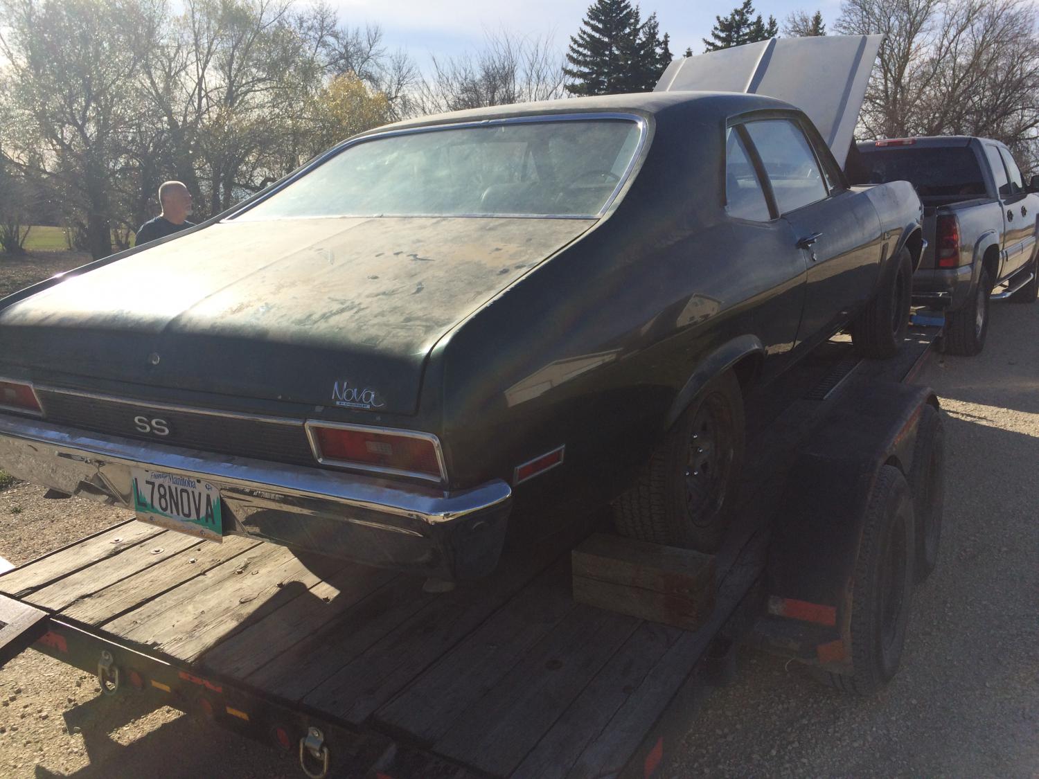

Name:  L78 Storage 001.JPG
Name:  L78 Storage 002.JPG

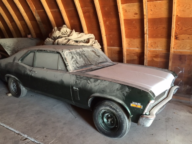

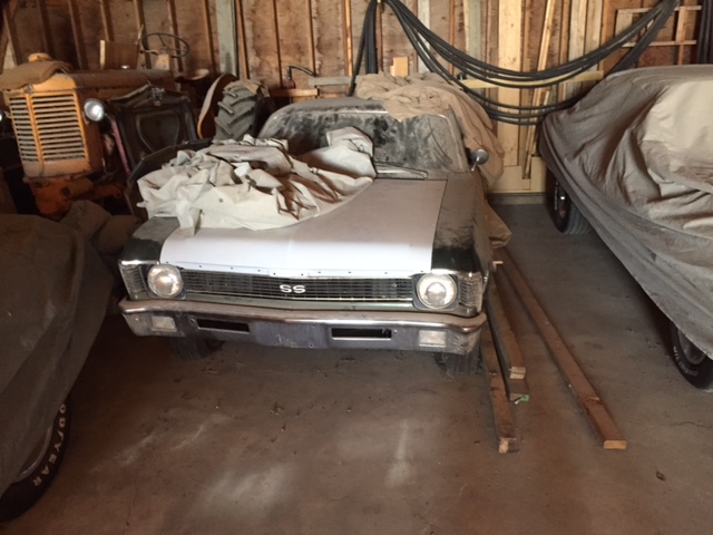

Having finished my Chevelle Convertible in 2015, in the fall of 2016 I finally brought the L-78 home for the first winter to get started. I only have a two car garage so summers are for drivers and winters are for projects. It had however been announced that our local World of Wheels car show was going to have a “Barn Finds” display in April 2017. Our local promoter Bob Chubala is a SUPER awesome guy and we wanted to support his efforts and have some fun. Myself and two other car buddies Dereck (different Dereck from the L78 owner) and Calvin, together hatched a plan to bring all three of our stagnant “project cars” to the show. So… my plans warped into doing as much work as possible without too obviously upsetting the “Barn Fresh” look (no washing Ha).
Name:  L-78 storage.JPG
After such extended storage the plan was, put a Muncie and shifter back in (ST-10 had been sold), replace the disintegrated headers (had an exact set of used Hookers at the ready), refresh brake system (restored master and booster were ready to go), SST brake lines, new rear wheel cylinders (cheap replacements for now rebuild the originals later), SST fuel lines, new fuel tank, install a correct BB style radiator, shroud and Fan (repop), new rad & heater hoses, repair the drivers floor, toe board, and the grenade hole for who knows what shifter was in there ??, Install the mint original ($$) rubber mat I had located (Thanks Yenko Site), install a correct original bench seat, re-install the original door panels, rebuild carb, fresh fluids, set valves (rockers had been backed off for storage), pre-lube, and fire to DRIVE it in and out of the show! Oh and throw in a couple Auto Meter gauges under the dash for good measure… Short List And we begin;

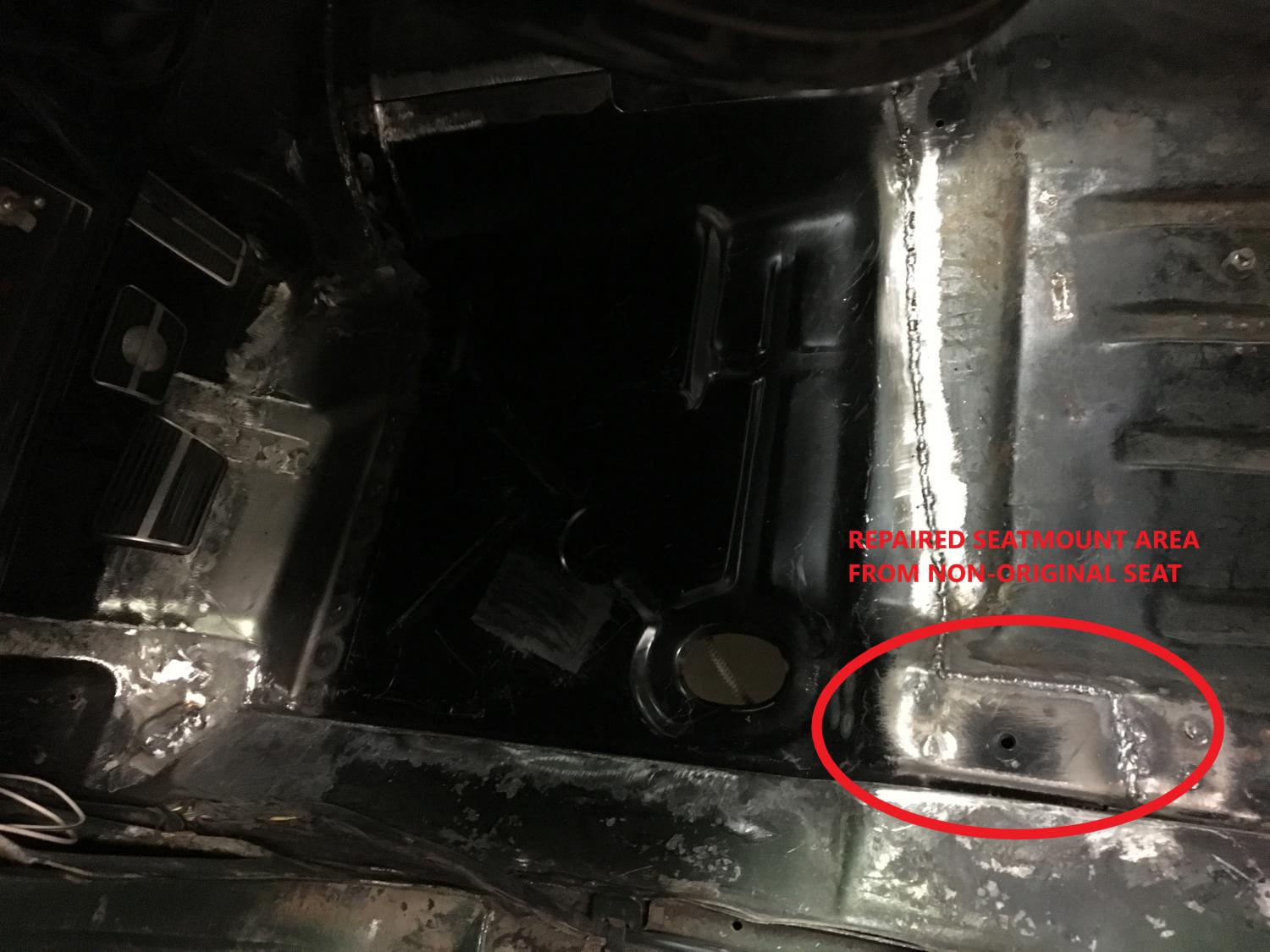

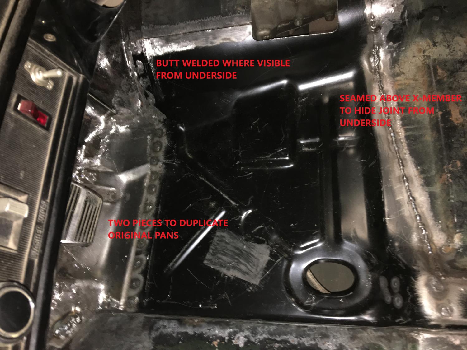

A portion of the drivers floor was rusted through (4-6”under heels and 3-4”up the toe board). To make the repair undetectable from the bottom side I decided to replace the pan section from the under heel seam all the way back to the under floor crossmember where it could be welded from topside and not be visible from below. The pan had enough metal to wrap up the tunnel and be trimmed to exactly match the original shifter hole cut out. Between the few original screw holes that remained and an original lower bezel, I figured it out. The toe board was trimmed to required size, plug welded at the seam (per factory spot welding) and butt welded and metal finished where it would be visible along the top edge and in the portion in the tunnel. Some of the final welding was left for the rotisserie later because it was too difficult to access assembled. The underside forward body brace was surprisingly solid (it is heavier gauge).
Name:  DRIVERS FLOOR 001.jpg

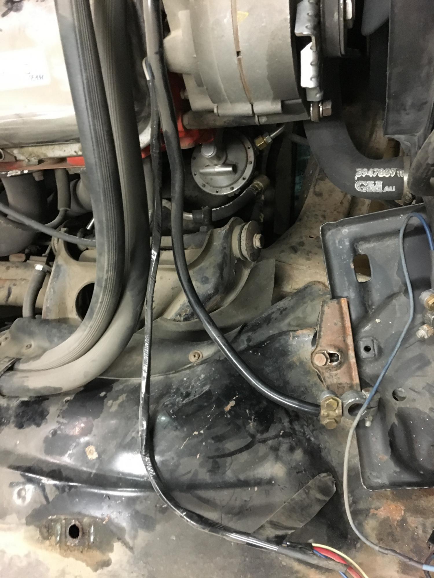

Green Bastard part one. At some point the car had been fitted with a GM bench seat with a fold down arm rest (Monte?). It was done early in it's life as I always remember that strange seat in the car. To accommodate the seat, the section of floor pan at the front seat mounts was POUNDED down to lower the seat…. A LOT… 2+ inches!! It took Herculean effort to reform (pound back up) the sections and weld in patches to make it fit a stock seat and be indiscernible from both sides
Name:  Seat mount repair 001.jpg
I mentioned Ken was from a small town and working on the car I quickly learned that every orifice under the car was completely filled and plugged with dried silt from gravel road spray residue. It gets everywhere and hardens like stone once dried out.
Green Bastard part two. Anyone who has run high speeds on gravel roads with a carload of pals knows you often times bottom out. The rear foot wells (floor pans) were so hammered up it literally took a sledge hammer and my trusty chunk of RAIL to coax them back to position and a several hours of hammer dolly work. More Herculean effort. I considered replacing them but they were very solid and in the end turned out surprisingly well.

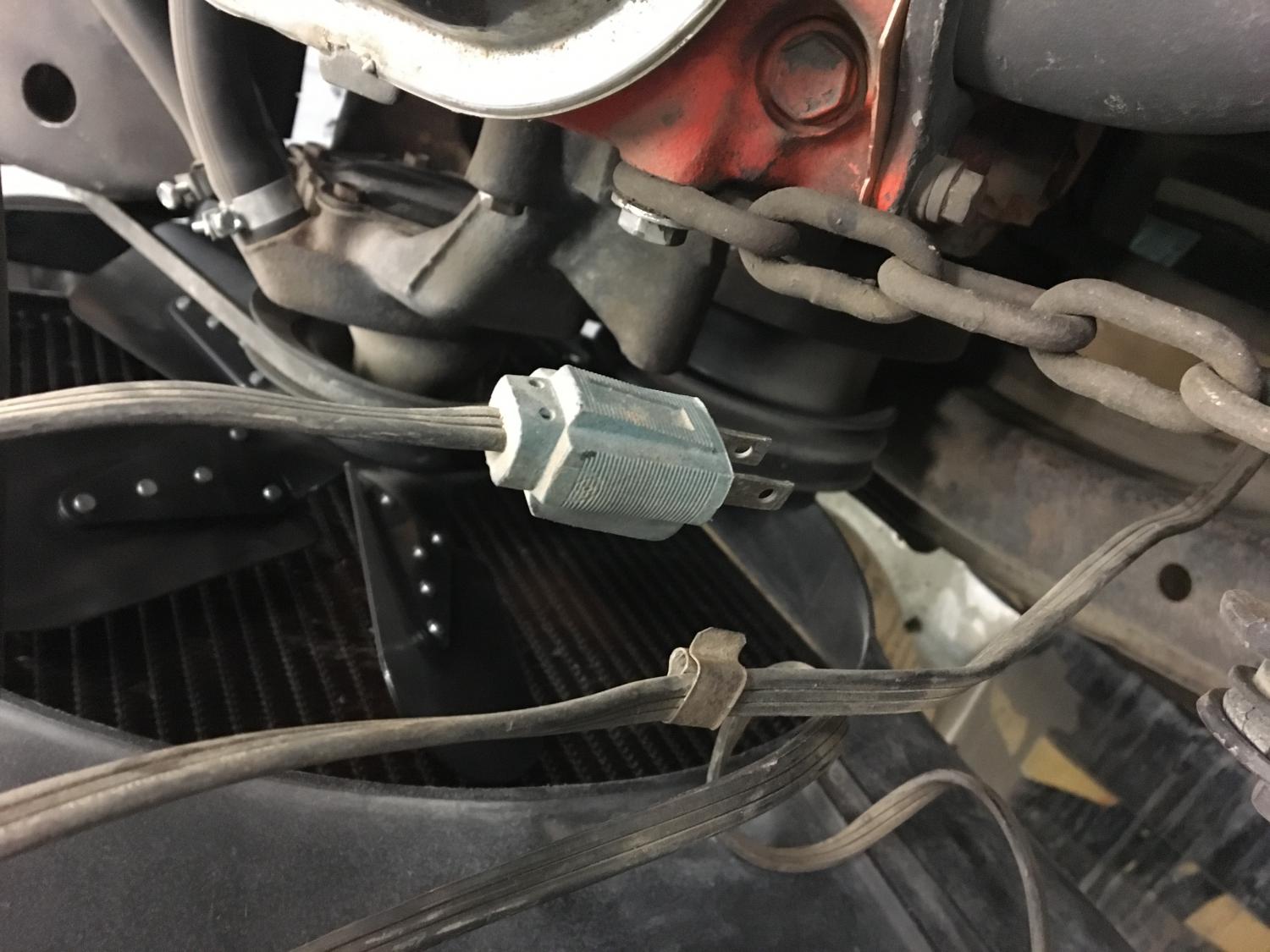

The radiator was purchased locally from a 68 BB Camaro (which went to Aluminum). I had also bought one from WilmasBoy here which will end up in my Acadian at some point. Shroud was purchased from GM way back when I bought the car. Fan is a repop and is a decent piece if you’re not concerned with full concours restoration (which I am not). In your face is what I believe to be the original equipment block heater plug, welcome to Canada. Also notice the chain to hold the engine under torque. The original equipment engine mounts are still in the car. Recall how Mr Fast said he launched the car

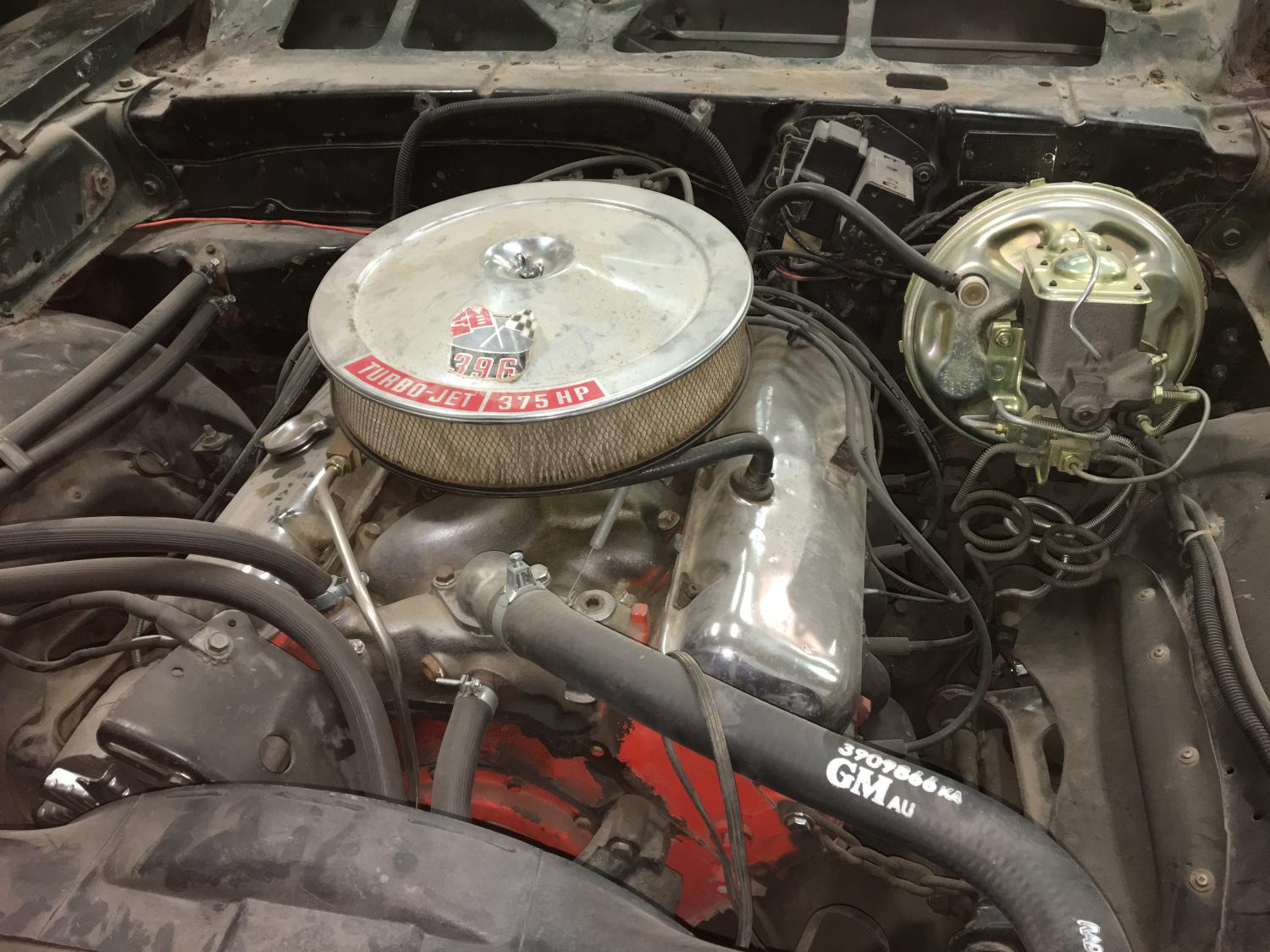

Most of the rest was just plug and play with a little cleanup along the way.
Attachment 211857

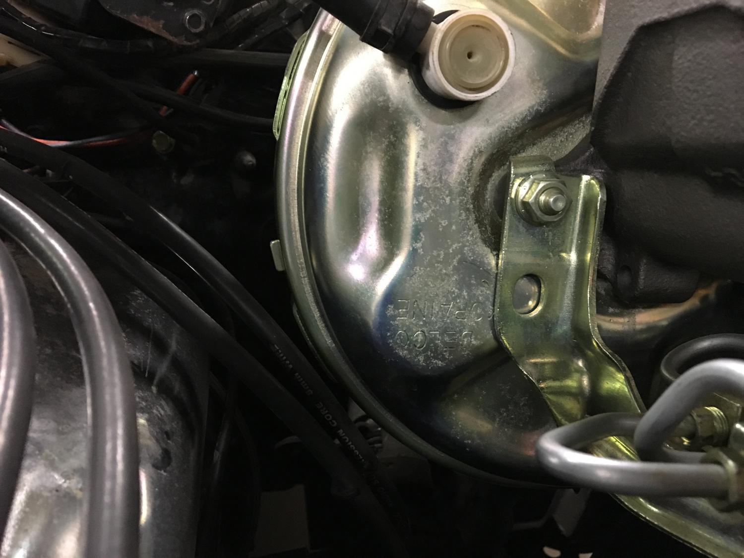

Name:  Brake Mstr Bstr 001.jpg
Name:  Brake Mstr Bstr 002.jpg
To be continued Barn Finds PART B

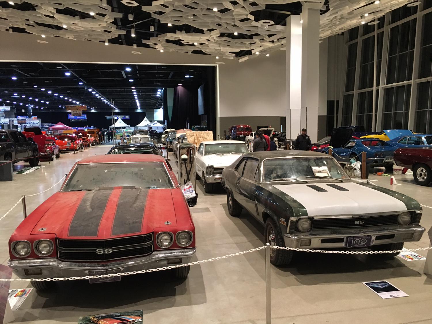

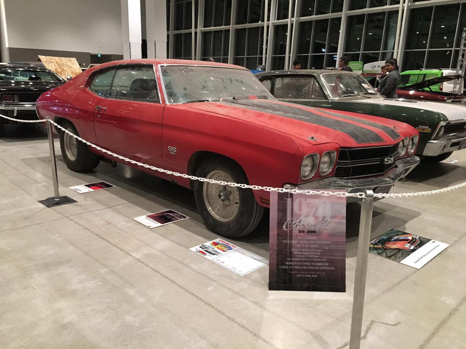

So all three of us had big plans to have these dinosaurs fired up and drive into the show and all three of us had issues but they did all run and we made it in (even if we did trailer). AND WE HAD A BLAST THAT WEEKEND ! We thought it was display only and were surprised to find out we won awards.
Name:  2017 Car Show 001.jpg
Name:  2017 Car Show 002.jpg

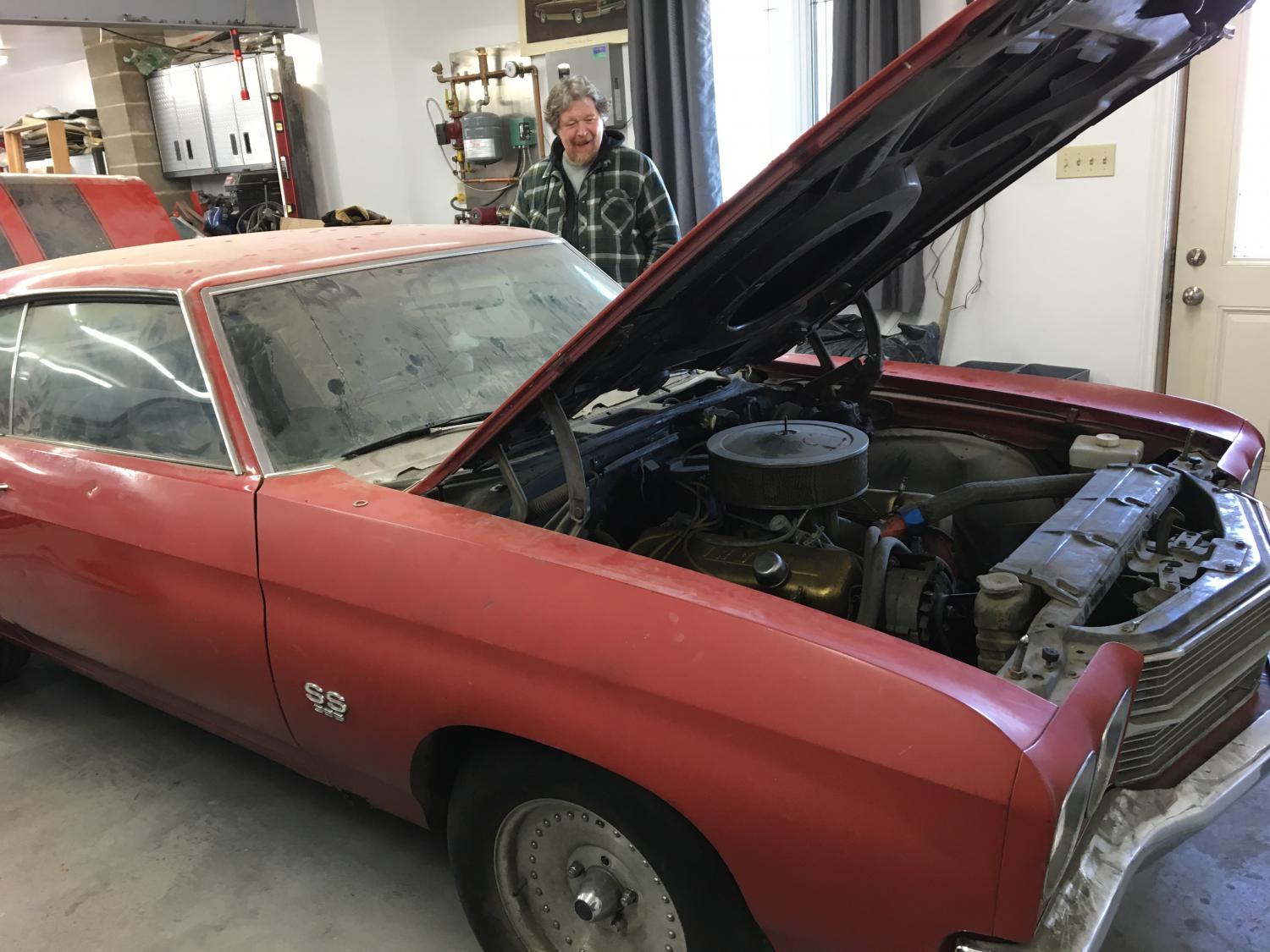

3rd place Calvin’s 1970 Chevelle L-78 He’s owned since High School !
(Tammy calls it HER car as she drove it lots back in the day as the DD)
Highlight : A young guy at the show says man that looks like my Dad’s old car. Well probably not because this one is from Thompson MB (Way North). Well that’s where we’re from too. Next Day previous owner shows up at the show… sat in the car for a while and says “Wow that was like an Acid Flashback Man”!

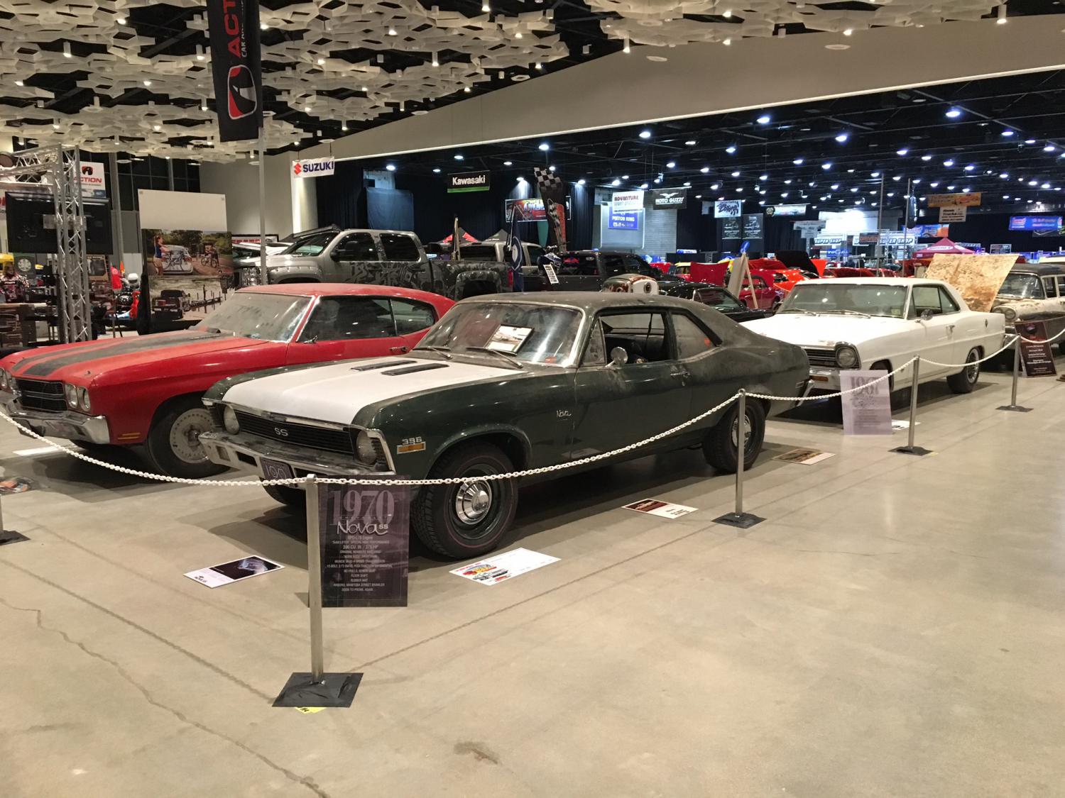

2nd place My 1970 Nova L-78
Highlight ; Upon arrival for setup, unload off the trailer and idling over to my spot some guy yells out “Hey that’s my old car… Mr Fast (Originally had sold the car because he was moving to BC, had recently moved back to Manitoba).
