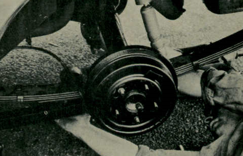

I had started a thread the other day pertaining to the correct color of the 67-69 Firebird Axle Colors. This thread is "69 F Body Rear Axle Color *Latest Consensus*"
With some great response it is easy to conclude that PONTIAC axles in that time period were shipped from PONTIAC and were bare steel and were hit with overspray of black after install into car. See the photos on that thread. So the proper restoration is Cast Gray center section and natural steel tubes and backing plates with the overspray of black.
It was also concluded that all CHEVROLET axle ship from a different axle plant and were always painted ALL BLACK. Everything except the yoke and the wheel studs.So the question is that since all 1970 Trans Ams along with 71-72 GTOs with the 455HO had CHEVROLET 12-Bolts installed it should be easy to assume that these axles were also painted ALL Black just as the Chevrolet Counter parts were. I inquire as I have been restoring a 70 RAIV TA for some time now and currently have the 12-bolt axle painted in the way you would a 67-69 Firebird or GTO i.e. Cast Gray and Natural Steel. I am thinking this is incorrect and should be ALL BLACK based on the evidence as shown on the previously mentioned thread. I know there are some TA experts out there on this forum and would love to have comments / thoughts before I post same question on PY Forums. Seems there is more expert participation on this site.
Thanks to everyone who chimes in.
RA

Originally Posted by William View Post
I'm sure they didn't intend to paint the studs but occasionally got carried away.
As I noted in the other thread, the wheel studs had some sort of sleeve (I assume cardboard or tubing) slid over them before the paint was applied, so the threads did not get painted. On low mile survivor 65-67 Chevelles you can see a donut of bare metal on the drum face around each stud, that shows where the outer diameter of the sleeve was. You can also see paint on the very end of the studs, so the sleeve was open on the outer end.
The studs were plated with a black finish to begin with, explaining why the threads also appears black in that pic.
Also note that hex shaped bare spot around one of the studs in that pic. Suggests that at that time frame (is that a 68 in the pic?) one nut was run on one stud to hold the drum on during shipping and until final assembly of the car.

Yes. Later the one nut was changed to a push nut.
Photographic evidence indicates that the axles were usually all black for the 12 bolts and the early 10 bolts.
By 1973 the center section was typically shipped natural and the remainder of the axle was still painted black.
By 1975 GM discontinued painting axles all together. The shipping racks and the assembly process at Norwood left significant cosmetic damage to the underside of the axle tubes and quality scoring was tightening to create competition between plants. GM Assembly Division was pushing to get rid of the paint altogether in order to raise the quality score due to demerits that the assembly plant had to score against their own assembly process as the scratching was a normal and unavoidable outcome of how Norwood handled the axles for assembly. As a compromise GM engineering adopted the position that surface rust alone provided a sufficient corrosion barrier to meet the survivability standards required by the warranty commitments at the time of sale and since there was no paint to mar or scratch - the quality demerit issue was removed making Norwood slightly more competitive with the other assembly plants using more up to date conveyor material transport systems.
