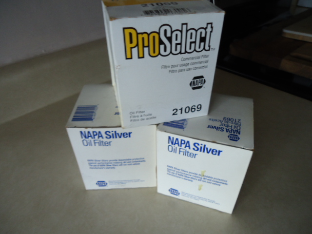

You'll probably get a bunch of answers here. I use Valvoline VR1 & always a Wix 1st line filter. Napa 1st line used to fit in that group but unless it say made in the US, it's not a wix in the NAPA box....Joe
