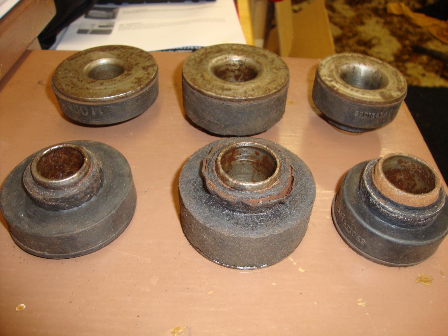

is it possible to replace the bushings without dropping the complete sub frame car was restored with aftermarket bushings but i found a nos set

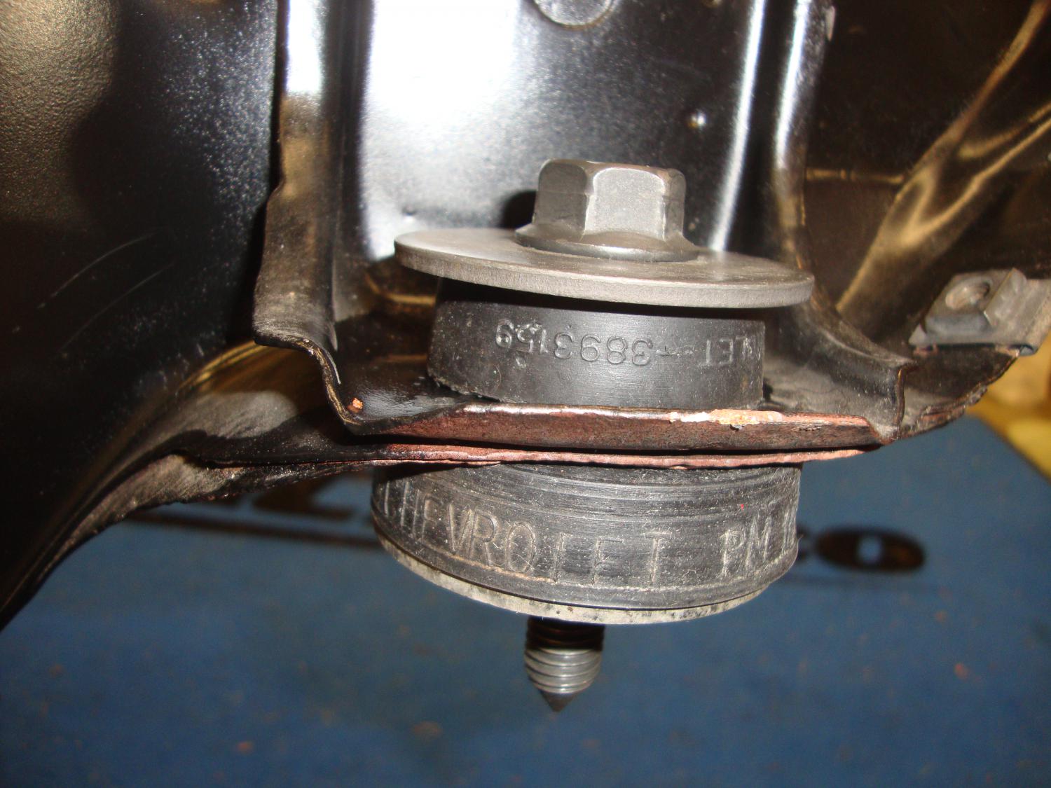

Old 10-22-2023, 10:59 PM
169indy's Avatar
169indy 169indy is offline
Join Date: Oct 2001
Location: Washington
Posts: 825
Thanks: 1,210
Thanked 806 Times in 263 Posts
Default 1968 Swap import Bushings for NORS GM parts
Done
Mine No Motor,
One side at a time, Front end loose A partial Project car.
Loosening Fuel and brake lines clips/retainers.
Jack body at rocker to gain separation distance.
69 Los Z11
68 SS/RS 396/325
68 Los Z28
