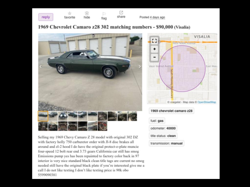

California Black Plate car
https://sfbay.craigslist.org/sfc/cto...519891415.html

If That’s legit isn’t that a great deal?

Nice original car. Love the dirty engine compartment that tells me this car is legit and engine never touched. Price is steep, seeing these Z's go for 100,000 dollars restored. But if this car is what he says it is, that price to me is fair.

Looks great but more solid proof of JL8 originality than a POP necessary.

124379L512994?

Car is on Facebook. Not a factory JL8 car and he knows it

Also that is not an untouched original judging by the firewall and the baggy looking reupholstered headrest.
ZL2 was also added.
Said it was repainted back to original color in 1997.
Drive train stampings will tell all here.

BU on PoP so it's a normal factory 3.73 12-bolt. Way over priced at $90K given condition.
