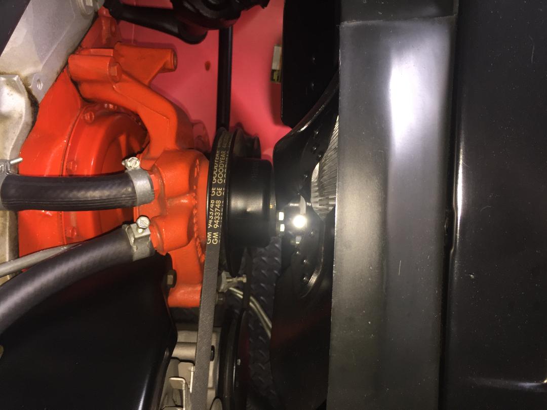

Helping my neighbor with his 69 Chevelle re-fresh...have a few questions:
Malibu cloned to SS396...325hp w/ 4spd and power steering.
-the fan shroud doesn't look deep enough...fan blades are barely inside...the shroud measures 2.5 inches in depth...seems to me it should cover the blades more completely. He has a long water pump...with clutch fan setup.
