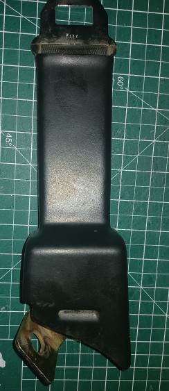

Got,cha you must be referring to the seat belt retractor cover , the hole assembly has to be replaced because the steele buckle is wider than the opening in the plastic cover unless you remove the buckle and resew it. This is a replacement for my nova in the pic below .

The retractor cover on the 69 Camaro is a little different, but I was able to remove and reinstall it by heating the cover in hot water, making it much more pliable. As I recall, it was still a challenge, but doable.
