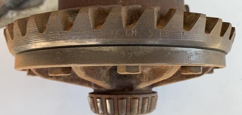

The format is letter number letter. Here is one stamped C 22 H from a 10 bolt 3 series posi.

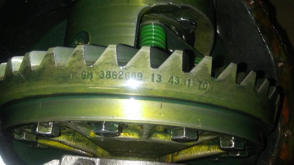

Here is jan. 22 assembled rear gear.

Thanks for posting that. The posi assembly date stamp is late 69, fits fine for a Jan 1970 axle assembly.
