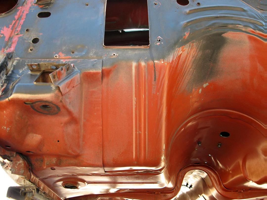

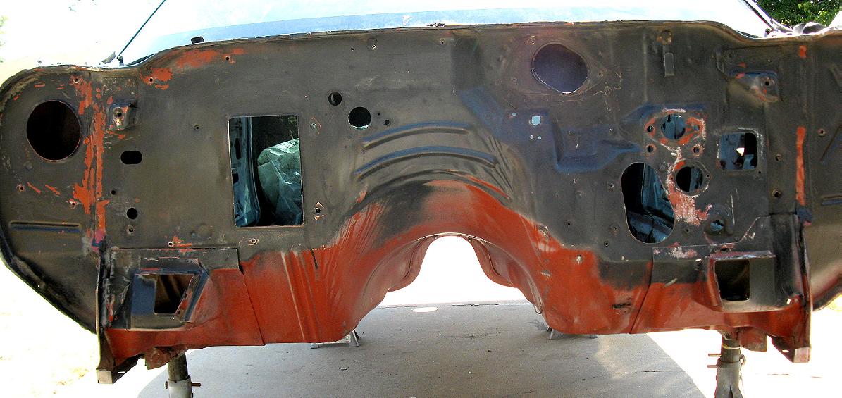

Old 02-08-2025, 01:36 AM
Posts: 2,714
Thanks: 130
Thanked 297 Times in 104 Posts
Top pics are Original Firewall Black out
Lower is picture of my Z28 Firewall
Some of us are using SPI (Southern Polyurethane) Red Oxide (blended with Black) to acheive the correct 70 Norwood "red oxide"

Old 02-08-2025, 01:43 AM
Lynn Lynn is offline
Location: Oklahoma
Posts: 7,946
Thanks: 111
Thanked 3,742 Times in 1,575 Posts
Chuck; I think you forgot to attach the pics.
