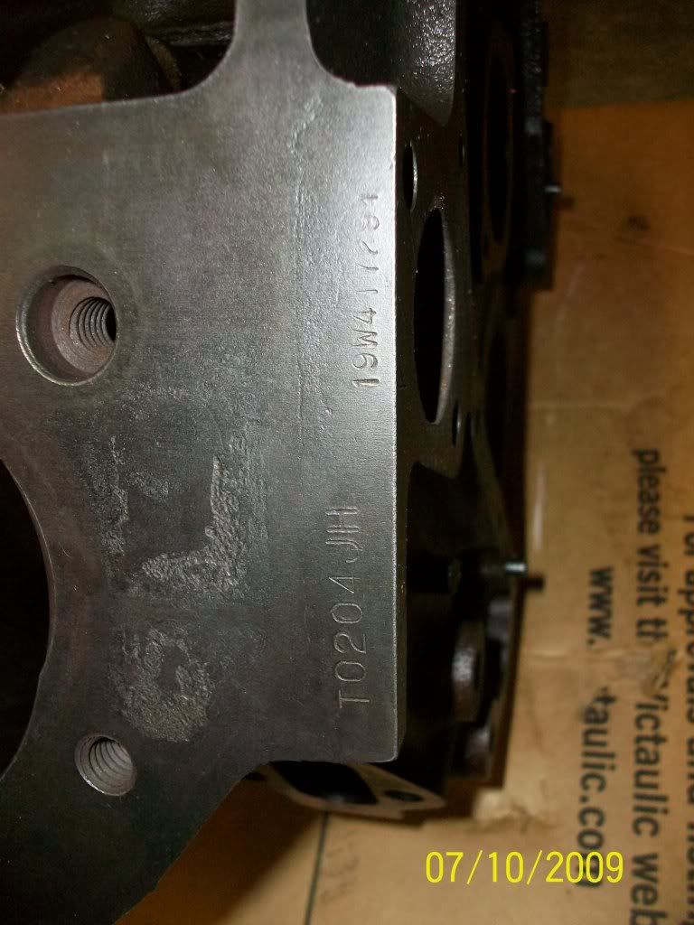

Probably one of most horrendous re stamps I've seen in a long time, but interesting paper.?

The VIN is stamped… not 100% convinced the JH is though.

the TO213J are probably original, but the last letter removed and a H added.

Agree, H looks added to me

The block stamp is not correct for that Nova.....the protect-o-plate is T0403JH for a 04B build date. The block in the ad is T0213J.....H......and as stated above, the H has been added. Plus, the VIN is definitely a restamp.....the font for the "W" is wrong.

So everyone trusts the POP? Something is obviously amiss. The block is wrong or the POP is wrong, or both. What does a Willow Run partial VIN look like in that time period? I’m not interested in the car. I also agree that the pad is unusual and has been hit with a die grinder scotchbrite. The later stamped H is certainly not typical but I’d like to hear more opinions as the fonts on the assembly stamp look good to me.
