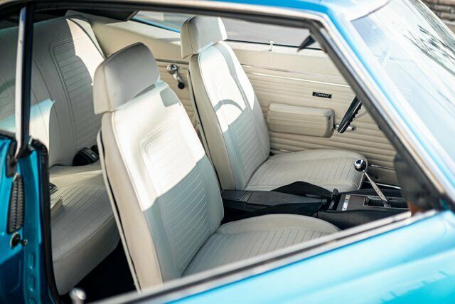

This one evidently sold in 2009 for $45k at the KC Mecum auction. No mention of it having its original motor then, and today the seller only claims the motor is 'correct' so I'm assuming it's NOM.
Pretty car, but for $129k I am a little surprised to see the saggy headliner, puffy repop door panels and missing smog system.
Link to 1969 Z/28 auction
124379N618450

Pretty car! Love me some LB. I would rather have Norcam’s car for that kind of scratch. I know the quality of the restoration Graeme’s car had and it was sorted.

That interior needs work!!! The fit on those seatbacks Headrests shouldn't be straight type.
$130K and 93 pics showing nothing that proves its even a real Z.
It must be real, it has DZ on the drivers side head! LOL

black grill, rear bumperettes instead of bumper guards, interior as mentioned.
Didn't likely come with gauges.
This guy is swinging for the fence with a toothpick.

Aftermarket brake combo proportioning/metering valve like the Chinese disc brake conversions use.
