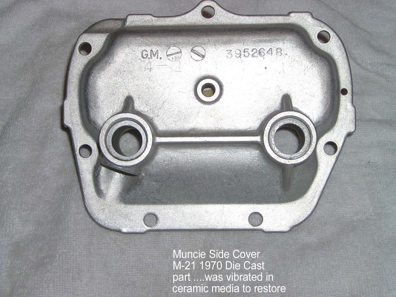

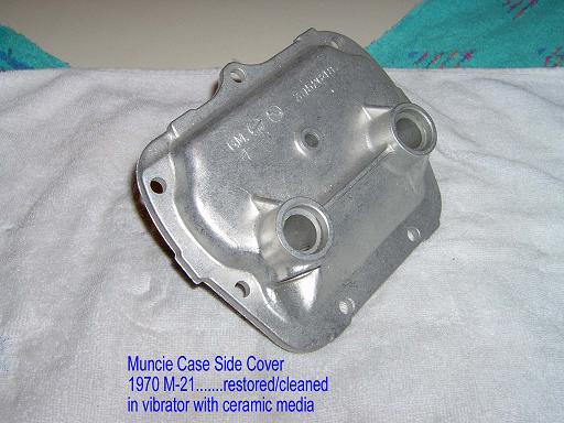

I have zero experience with vapor honing
I do have experience seeing Aluminum Sand Casted Intakes that were Metal Shot Blasted
as they were when mfg at a Foundry
See my alternator cases that were tumbled/shaken in ceramic media..........
Ive also shot blasted Muncie Case (Sand casting) and Tumbled/Shaken Muncie
Tailhousing, Side Cover

It matters if it's a diecast part or a sand cast part, very different finishes.
Most smaller parts are diecast and will have a smoother finish (because they were cast in a steel mold).
The trans maincase was a sand cast part.

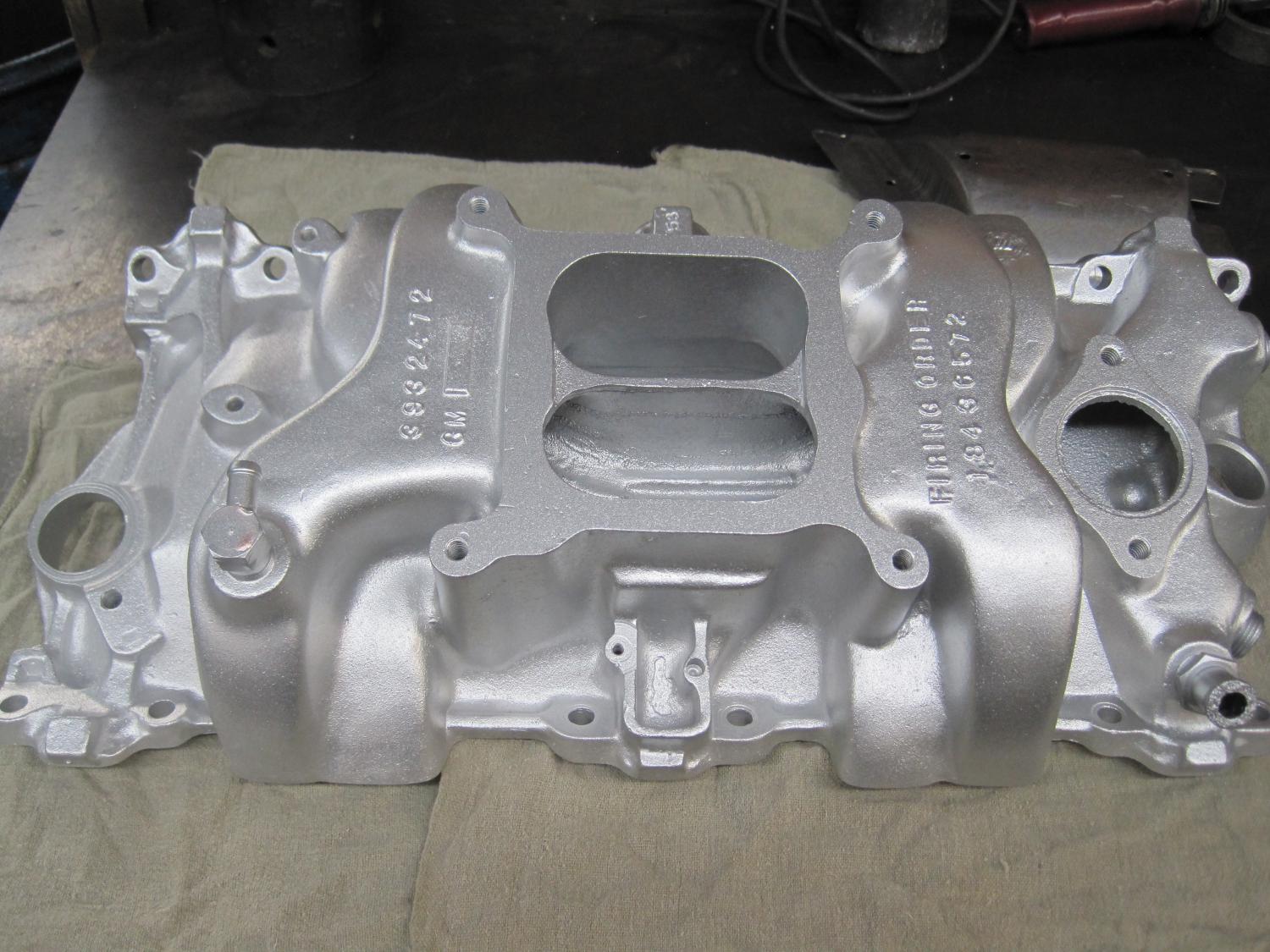

I have my own vapor blaster and I can vary the finish.
Sometimes I get a part the way I want it and later I decide I want it just a little less shiny or it’s too dull and I bring it up w a differnt mix or even different amounts of air pressure.
These pictures are from when I first started and I was playing with parts to get the right sheen.
Gives a good idea of the differences.
Trans case is just cleaned vs vapor blasted.
RAIV intake was dull after being, just cleaned vapor blasted half in first pic and then Finished.
