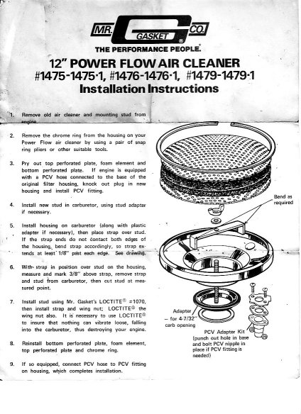

I'm in need of a low profile (very low) air cleaner for my son's Corvette. Thinking that a Fly Eye would be a great Day Two option. Does anyone know where an affordable re-pop can be had? Not sure that I'm ready to cough up for an original.

I think the zig-zag wire goes between the two mesh screens? I see some with the zig-zag wire visible and some without.
Old 06-07-2020, 12:16 PM
JoeC JoeC is offline
Location: ri
Posts: 3,756
Thanks: 471
Thanked 2,601 Times in 644 Posts
the zig-zag wire holds in the mesh screens and filter.
the zig-zag wire came later
the early fly eyes had a large chrome snap ring to hold in the mesh screens and filter
