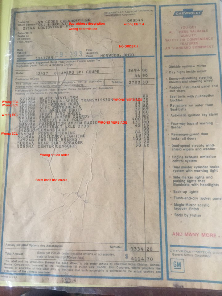

Questions arose regarding the purported "original window sticker"
Here's a quick analysis that covers most but not all items, see attached:
[email protected]

Great analysis.

I wonder if the current owner knows it’s fake?

Great analysis PAUL - would you have done it correctly and if so how DO WE TELL YOURS from FACTORY if yours are CORRECT?

Just ask, I have records of all reproductions......and any resto-mods or non-authenticated cars all have watermarks on all documents.

Just love how someone purposely aged this one to appear old and original.

Now a restro mod window sticker would be interesting. LS motor in a 69 camaro. That would make people look. Thanks for pointing out the errors. Someone tried to fool people
