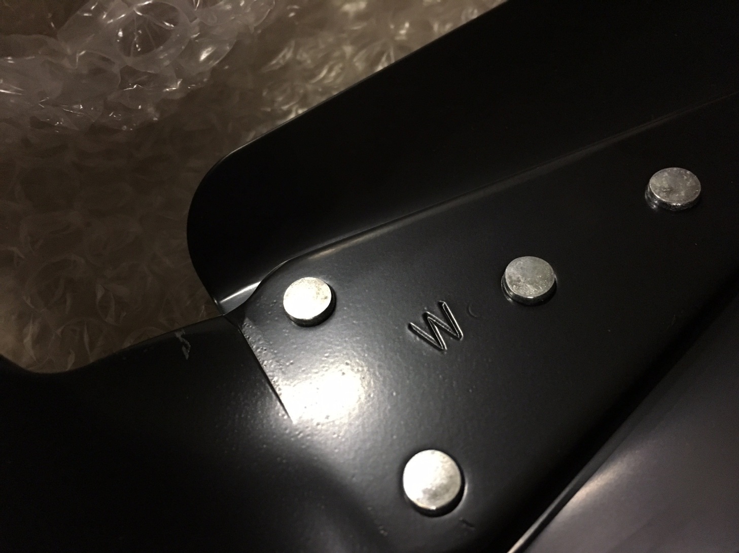

Anyone ever use the repro 5 blade fan? I don't want to spend the money if it's junk, I can just put a flex fan on it for now but I gotta get the 1" fan spacer.... Earl's got one on EBaY!!

M....I think you will be happy with the US Radiator unit...I have a 4 core version in our 68 BB and it works fine. Also had a 4 core in the 70 TH400 car we sold...you can't use an old style flex fan with the 4 core...but the newer style will work. There is a 6 blade steel fan available, I think Wayne Bushey has them...I have it on the 68 car...it works good.
As for the repro 5 blade...I have no first hand knowledge...I know folks have bought them...maybe someone will chime in.

I purchased a repro 5 blade recently... works fine... no spacer. It's a tight fit with a 4 core (re-cored) original Camaro BB rad !! also close on the rear side to the alternator pulley.
I do not have an original for comparison but this piece looks pretty good.

Marlin, i also bought a repop fan and it works fine. No spacer...

Repro fan arrived yesterday, will trial fit tonight - sure looks nice, even has the 'W' stamped on it. Wonder how close they are to the originals?
