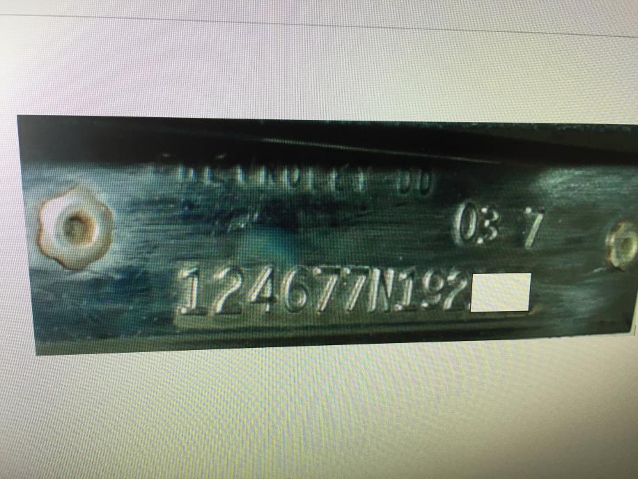

Did only festival pace cars have the delivery date stamped on the vin tag from the factory. I looked at a pace car awhile ago, but i did not buy it. The NCRS came back as chevrolet Milwaukee Zone. Any ideas if this could have been a festival car?

Quite a few 0-1 cars went directly to dealers. The body number spread is a better general predictor of zone 025 shipment. This can be verified through the NCRS shipper report.
037 and 047 stamped on the VIN is another indicator of potential track usage.

Many other 67's have the date embossed on the VIN tag, both coupes and convertibles.

I will have to check to see if i wrote down the embossed date on the vin tag. I thought only festival cars got embossed dates. Maybe the car i looked at was delievred to the milwaukee zone office to take to dealers to get orders for the pace cars?

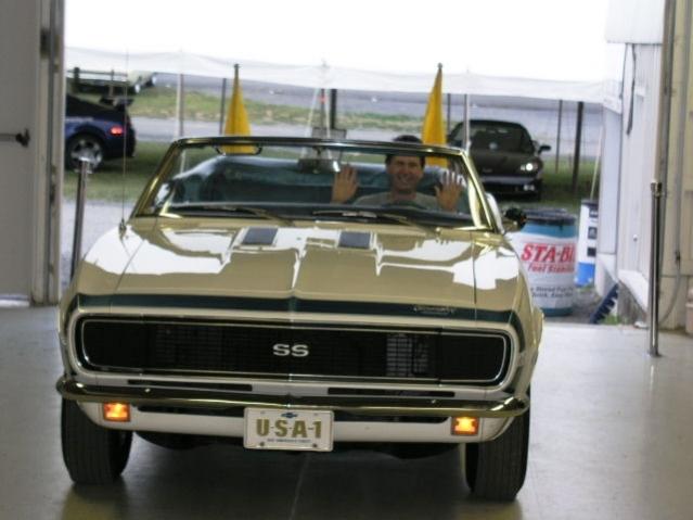

Look for the actual 67 Pacecar at this years MCACN......:-)

That Pace Car was fun to drive....thanks for the memories and opportunity, Charley!

I got to drive it shortly after Charley finished doing brodies in the grass at Carlisle..
