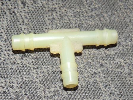

Seeing how easy it would be to change out, I would just get whatever for now. Eddie, I may have an extra, but I am not in that particular "bucket" o crap right now. If I come up with a second one, you are welcome to it.
Eric Jackson may have one as well. IIRC,they are white with little flat shoulders at the junction. GM used them for years, so should be a few out there.

Can someone with an original confirm that this is the T fitting Eddie needs?
