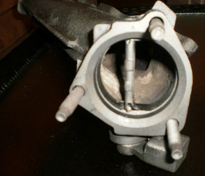

Just grind the flap off like i did in this photo and ad a hole with cotter pin so the bar can not slide out.
Works well for me.
The heat riser still works but without one side being clogged up for the start up. [img]<<GRAEMLIN_URL>>/biggthumpup.gif[/img]

So you are saying it is not needed for the choke to open. That the choke gets enough heat from the exhaust manifold to heat the spring to open.
