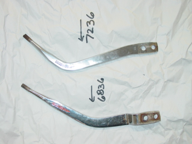

I'm putting an m-22 in my 72 nova behind a 454. The transmission currently has a Hurst V Gate inline shifter on it. I don't think it will be much fun on the street even if it does help at the track. Besides, it requires a Large hole in the floor. I am considering a Super Shifter or Competition Plus. Does anyone know what Hurst stick/handle I'd need to use in my bench seat car? I really appreciate any input. Thanks a Lot!!!

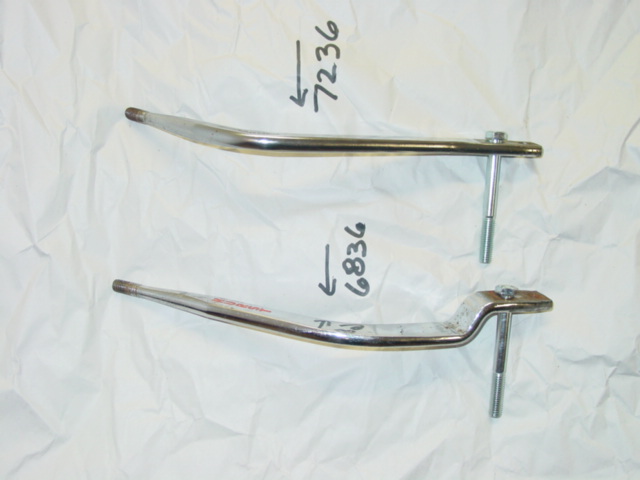

Hurst says to use a 538-6836 shifter handle...
But I have some customers that like the 538-7236 shifter handle for this same application...
I have some complete Nova Comp.+ shifters in stock... Crash
