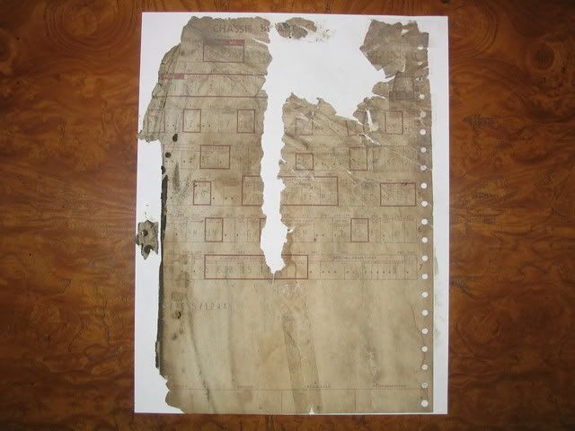

The buildsheet should look like this... Hopefully in better shape.
Old 02-20-2008, 09:15 PM
COPO 70 RS/Z28 COPO 70 RS/Z28 is offline
Join Date: May 2007
Location: South of the cheddar curtain
Posts: 935
Thanked 6 Times in 4 Posts
Default Re: 1969 Z 28 LOS ANGLES BUILT
That looks quite a bit different than a 70 build from Van nuys.
Is'nt that a "broadcast" sheet?
Hey Rich,
A liitle off topic but what are the hand written letters (maybe initials) under the COPO note on the build sheet.
Any idea, Mine are different than yours??
Carl
