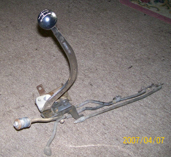

Does anyone know what the correct shifter for a 69' Biscayne L72 M22 car would be? Hurst or Muncie? It has a Muncie in it currently, not original to the car however. I have included a picture.
The original shifter is a Muncie and don't be too quick to determine the one now fitted is not correct for your car. The handle in your picture is a chevelle bench from what I can see but that does not mean the rest of your shifter is not correct fullsize.You have to look at the mounting bracket where it bolts to the cross member to see if the front bolt tab turns to the left or the right. See if you can post a picture of the shifter mounted under the car and we will try to help.
The OEM shifter is a Muncie very similar to Chevelle. From your photo, the handle is correct for a bench seat. As has been mentioned, clear photos from under the car would be very helpful to ID the shifter.

Cool car...We have a gennie shifter we just picked up for Joe's L/72 Biscayne. I will try and get some pictures. A factory M22 car as well. LeMans blue black bench gut. Its good to see another one.. .BKH
