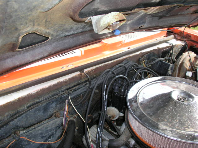

------Hey guys,,,Does anyone have or can anyone point me toward some pics of original paint 69 Zs. I am specificly looking for any pics of the fade of the stripe under the trunk lid and hood areas. Want to have my painter roughly duplicate the crudeness if you will. Also wouldnt mind a good close-up of the stripe up against the rear window of a non-vinyl 69 Z. This would be the later dimension version stripe. Thanks in advance for any help!!!.........Bill S

Here are some. I am sure there are plenty more examples out there.

-----Thanks Darren and Mike. Darren,,, I guess the one thing I could take away from your two pics is that the cowl appears to have been taped off, and the mask tended to lean one way or the other over the edge. Is that a recurring theme???......Bill S

Bill
I looked through a bunch of old print photos I had and found a few original 69Z's.
It looks like the rear stripes ended with a overspray pattern.
However, as in the pic's posted here I believe the front cowl was taped off at the bottom edge.
