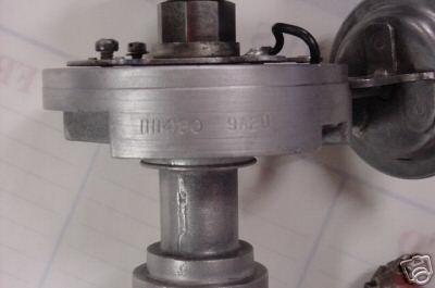

Default 480 distributor - is 9A20 a good date ?
Need an expert opinion, real or restamp ?.... thanks !

Default Re: 480 distributor - is 9A20 a good date ?
9A20 is a good 480 date but I cannot say for certain if the distributor is real based on those Ebay pictures. I have seen some fake 480's done so well, you need to mic the housing to find out if it is real or not.
It is impossible to certify a COPO or Z/28 as authentic without verifying that it is not a rebody...
thank you for the response, what should the mic read for the housing thickness ?
I can get you that number tonight. Looking at your attached picture, I am suspicious as there are a few things I do not like.
