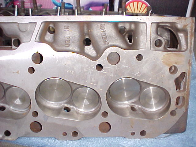

I just picked up a set of Closed chamber big block square port heads.
One is dated D 13 70 ( casting #291 )
and one is dated H 24 70 ( casting # 840 )
..What would the application be for?
....1970 LS6...or 396/375 or both?
Attachments - The Supercar Registry 295127-MVC-020F.JPG 295124-MVC-023F.JPG 295123-MVC-024F.JPG 295122-MVC-021F.JPG

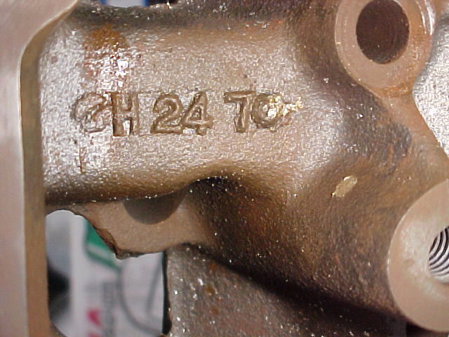

Here is the photo of the 840 head that I thought was
dated H 24 70 ...or am I misreading it?
...or is it H 24 7

Here is the other side of the same head

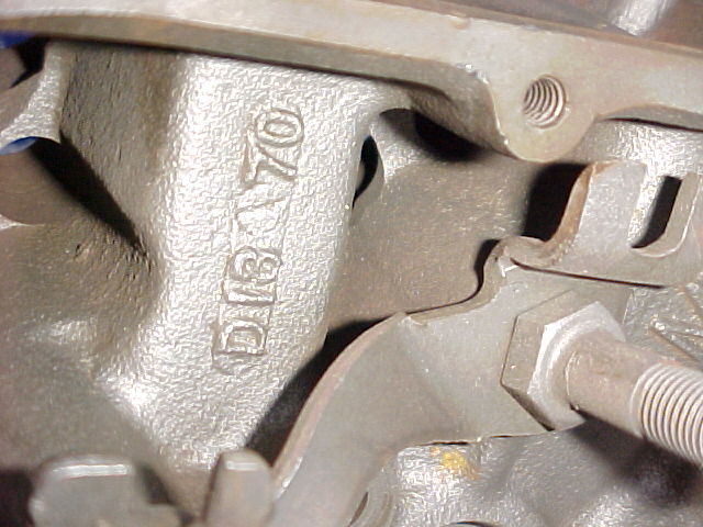

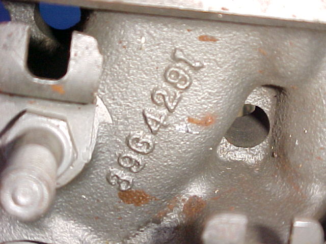

here is the 291 head dated D 13 70
