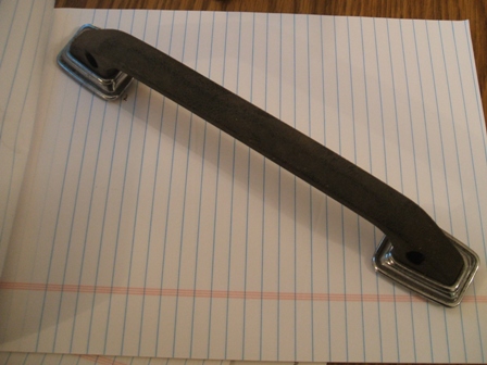

I have a pair of real nice interior door pulls, but cannot figure out an exact application. Part numbers on the attachments are 7779663-4 and 7779662-1. Pics attached

one more

You are relaying the chrome escutcheon numbers.
Those and the door grab handles used on 1968-69 Camaro & Firebird w/Deluxe molded door panels.
If Grab handle is molded in black,it's part #7770614.
#7779662 is the front escutcheon for right & left side,#7779663 is the rear escutcheon for right & left side.

Thank you very much!
