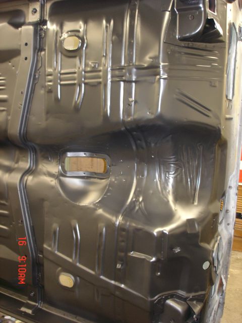

I got some epoxy primer put on the floor boards last night.Hope to get some high build primer on it tomorrow.

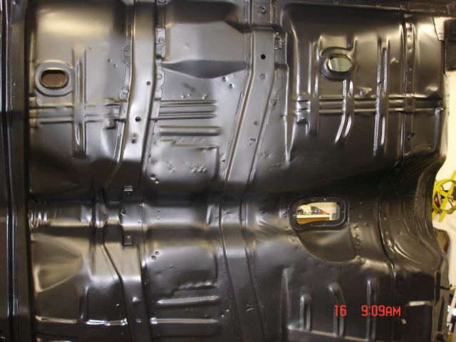

Here's another

Wow!!!.................Looking Good!!! .......Are we having "Fun" yet.........

if thats DP90 on there I wouldnt put anything over it I would leave it as is.
Looks real nice!

There is some minor pitting that I need to fill in,paint store told me to use a different building primer to take care of those.Also have a minor ding or two that needs worked out.

I'd spray some K36 on there, the sooner the better. I believe the DP90LF needs to be topcoated within a week (at 70 degree temp's), otherwise it has to be scuffed and resprayed with DP90LF before the K36. Additionally, if you decide to final coat it with DP90, mix it as a sealer to put some gloss into it - better yet, final coat it with a single stage black with flattener.
