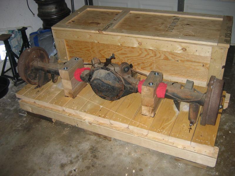

I have what I believe to be the rarest 12 bolt rear end. I am going to post the number code in a picture so you know I am not making this up. Please decode this and tell me what you come up with. The code on the drivers side front is GA0119B casting number 3859140N and the date is L214 (December 21, 1964). It also has the larger 11 inch drum brakes. I look forward to your responses. Todd

GA would be the correct code for a `65 Z16 Chevelle.

Thank you. That is also what my book has listed. Indeed I have one of the 201 original 12 bolts from a Z16. No doubt a Z16 owner will be interested in it. According to the website many did not survive due to the high gear ratio (3.31). How do you put a price on an item like this?

What I know about the Z16 rear end. It is unique in every way. It has special axles and tubes that are from the larger passenger car cut down to fit the Chevelle housing. So, it also has the larger axle bearings and 11 inch drums from the big cars. They only made this axle for the Z16 and we all know there were only 201 of those cars ever made. There is a Z16 owner out there that will be needing this correct axle.
