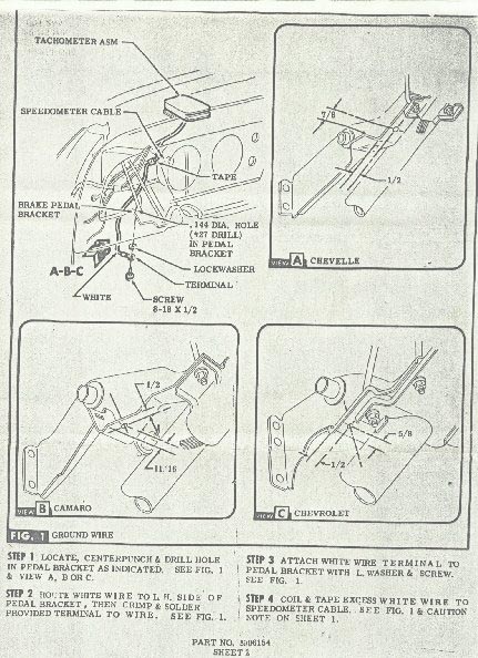

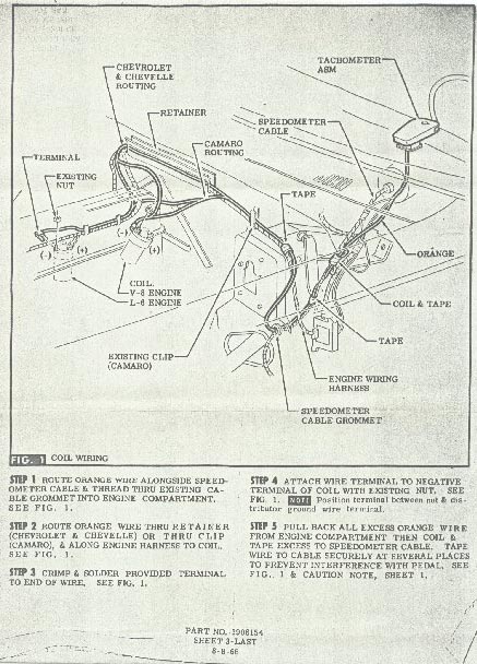

Hi, I am looking for a copy of the installation sheet for the top of dash dealer installed tach. This is the flat one that goes to 8000RPM. Also looking for the mounting bracket and screws.
Thanks for any help

Page 2.....

Page 3.....
