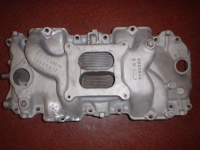

Can someone tell me the application of intake manifold #3885069?

Ebay 66 Corvette intake manifold
There's one on Ebay...

Marlin,,, Any 66 or 67 solid lifter big-block single four barrel except 67 L88. I think thats a correct statement. Someone will slap me if Im wrong. Date is on the bottom. Watch out for crudely cut down plenum dividers, and welds around the bolt holes.......Bill S

I agree !
