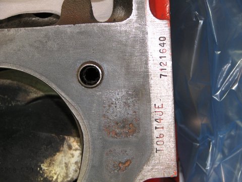

I would appreciate any pictures of a 1967 big block Corvette engine pad with correct stampings. I have beenb told that mine is stampted too close to the front, so I want to see if there are others that think differently. Thanks

Here's mine.

Here's a 67 L88 pad stamp I have.

Here's one from one of my 427/435 cars
