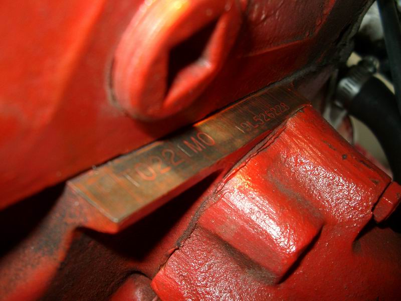

Has anyone here seen an LOS BB Camaro or Chevelle that has the VIN stamping upside down on the engine pad? I think that I've seen examples of this before, but want to make sure before pulling the trigger...Thanks

this is one I have..not sure if it is real or not as the car had some questions.

I don't know that I've seen an upside-down LA stamp, but I've seen a few Corvette stamps with the VIN upside down. I found a shabby old '67 Corvette here in Austin with the VIN upside down and famous Corvette collector (rest in piece) Roby Price made famous a black '67 435 Corvette with an upside down VIN. Some say it was nothing more than an error, others say it signified a shift change or closing of the plant for a holiday weekend. There's not doubt that the upside-down stamp did occur. I wouldn't consider it a knock out factor by itself.

Yes, had a yellow low horse 67 RS SS auto car a few years ago.

I've seen them before too but not specific to any plant, vehicle or engine options. .
Sure was easy enough for it to happen being a human on the other end of the gang stamp and remember as long as the number was legible, all was Ok on the line. .
Is it a whole car you're looking at or engine only? .
If a car, how's things look when you compare the fonts, spacing etc. w/ other Vin locations remembering the same gang stamp was used? .
If an engine only, aside from the upside-down thing, how's the fonts, straightness etc. look otherwise? .
Is the window of Vin production date good when comparing to the engine build date? .
If you have concerns also have time before you have to act, try to find a close Vin and compare fonts etc?
Gotta' think if someone was pulling any restamping tricks, why draw attention to anything by stamping upside-down? .

The Leeds Chevelles are the only plant that consistantly stamped their VIN's upside down though you and I both have seem some abnormalities especially at the LOS plant. I do not have any LOS cars documented (1970 only Chevelles) with upside down VIN's.

Thanks guys! Pete, it's a car and everything looks fine otherwise. I am waiting for a better engine pad pic before making a final judgement on it.

yes my l78 leeds plant 70 chevelle was stamped upside down
and I have seen a few others origional cars documented too that were stamped upside down.Include is an article from the chevelle report about the upside down leeds plant stampings.
