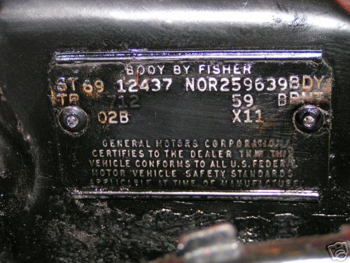

Hi,thanks for the reply,the vin is 124379N597591,and tag is NOR 259639 TR 712 59 02B BUILD DATE X11 not sure on hole for cowl hood location,I am new to Camaros.Thanks

A few days ago a friend showed me the Ebay ad on the car you bought,X11, BB heater core, cowl switch on accelerator arm, etc. It really looked not messed with. Either way the parts were worth more than you paid. If it had a real BE that is a great bonus. Post some detailed shots of the firewall, cowl switch, BE stamp, etc. The trim tag was re-riveted for some reason. Early build for a real Copo car thats for sure. You never know. Good luck.

If the trim tag was re-rivited,then that would be interesting,the only way to tell then is by the vin?Here is the trim tag

Those rivets don't look original!
