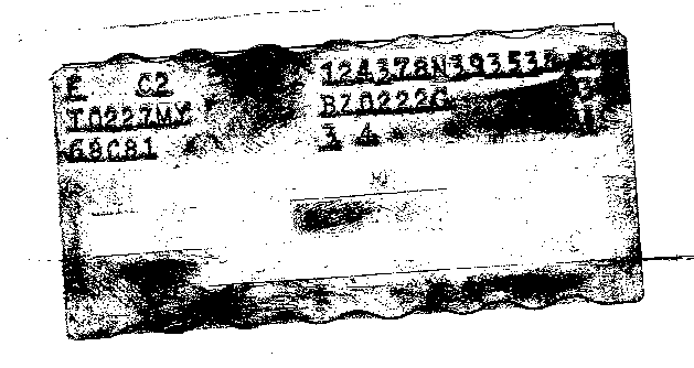

Anyone good at decoding a POP? See Attached.
Extreme Right is
R
3
1
1969 Camaro L-89 Convertible

Is the R on the first line of data, 3 on the second line and 1 on the third line? If so R is Rochester (for the carb) 3 is the build month (March), Last digit should be a little chevrolet bowtie, not a 1.

T0227MY - L35 built 2/27
68C81 - TH400
BZ0222G 12 bolt, 2.73 open
Is that last digit of the VIN a 2? Hard to tell....
