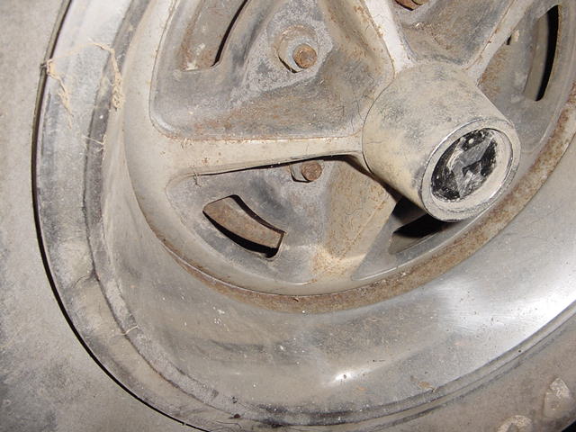

Pretty crusty, but here's an original Yenko Deuce Magnum 500. Initially i thought they were gray, but under the layers of corrosion and filth, they seemed to originally have been flat black.
As Erik said, these wheels were purchased directly from Motorwheel and may have possibly been finished differently than the production pieces used on Chevelle, Camaro and Nova.

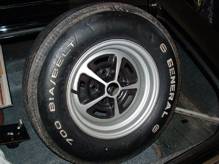

ATTN; RICK NELSON.
Rick, Do you have the shots of my spare I sent you a few weeks ago? I can't put my finger on them.
Jim, I sent a few pix of the wheels on my car but I also have shots of the spare which has never been on the ground. Should be a fair representation of a '70 wheel since it's never seen daylight. Unfortunately, even a good digital shot isn't as good as having the real thing in front of you.
Here's the best I have at hand.

Good pic there Joe/Eric The color of the wheel inserts has been the topic of much debate over the years within the Yenko Deuce community, with no real conclusions yet - except that both black and charcoal have been found.
The set of NOS Magnums pulled from Yenko's shop are still in the Motorwheel boxes with yenko labels on them, and they are reportedly charcoal. Several cars have been found with black, others with charcoal, so it's still a tossup.
I painted mine black bec/ that is what I found on them, and they were original condition. I think the Wargo car has black, but I think Tommy K found charcoal on his original condition a/t deuce. So, it appears that both colors are applicable.

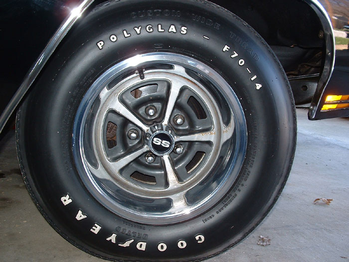

Now here is a pic of a "factory installed" Magnum 500 that was on a very low mile unrestored 69 L-78 Chevelle. It definitely appears to be more charcoal in color.

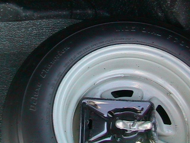

Here's a shot of the light grey backside on the original '69 Firestone Wide Oval spare.
