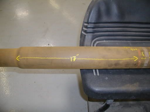

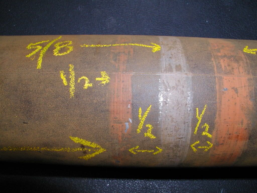

Howard, I have a 70 Chevelle that we are doing a chassis detail on. This is a code 34 (Misty Turquois) Kansas built car L34 350 h.p. TH400 with a/c. We found the original driveshaft as pictured. Hope this helps. Don
Oooohhh a Misty car...love that color!!!
ALbert
Albert, I bought that car about a year ago because of the rare color with a Build Sheet. I just did an underhood and chassis detail and probably will sell it this summer. Thought I could get my wife to drive a Chevelle but she'd rather drive her mini van.
