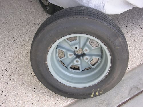

I finished my wheels yesterday and they turned out nice. Thanks guys.

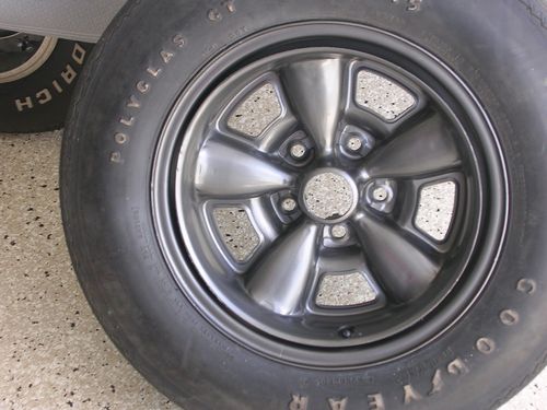

Default Re: Painting my '70 Z28 wheels
Front side
