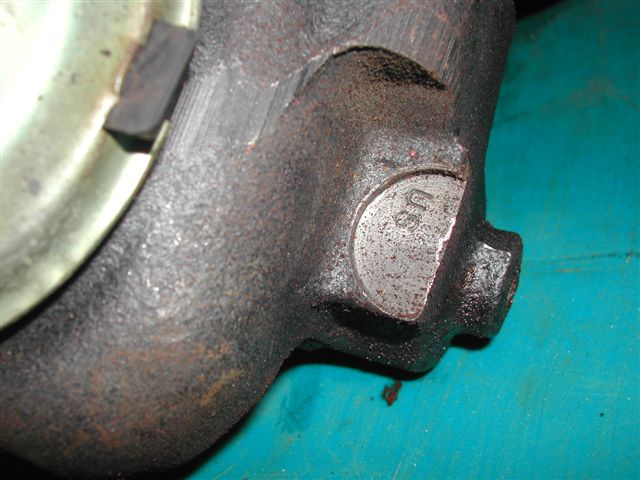

Thought you guys would get a kick out of these pictures. A couple members have seen these before, just never had a moment to sit a make a thread. This is what I call a nice unmolested Z28 Camaro.

I'm no expert on 69's, but is that the correct master cylinder? Alternator looks pretty fresh too.

HI WHAT MONTH IS THIS CAR SMOG PIPES DON,T LOOK CORRECT

I would say air cleaner lid, smog tubes and master cylinder but those are all just bolt on parts that can be corrected easily.

Car is a September '69 Build date... Everyone I have talked to has told me those a.i.r. tubes are correct for a late car. According to Jerry M's book they are different from the early car too. I have spoken to Jerry about them and he thinks original (if my memory serves correct). ATL has been rebuilt and restored, part number is correct though. This is not the first time I have heard the master is wrong. Matter of fact we have a slight brake problem with the car. Can anyone provide a picture of a correct unit? What is the part #? I would like to check while the car is still in storage.

Default Re: Deatiled shots: '69 Z28
Very cool
One question, if I may...
Has someone changed the carb? It has what appears to be a `71-`72 style throttle shaft and baseplate on it.

The carb has had a simple rebuild but I did not *think* anyone changed anything.
How on earth did you guys see the master... those pictures suck

The shape of the master cyl. gave it away it is square and the correct one Darren posted is round the part # is 309 and the stamp on the pad is US I will post a picture of the stamp in a few mins.
It's a great looking original car
Heres the pic...
