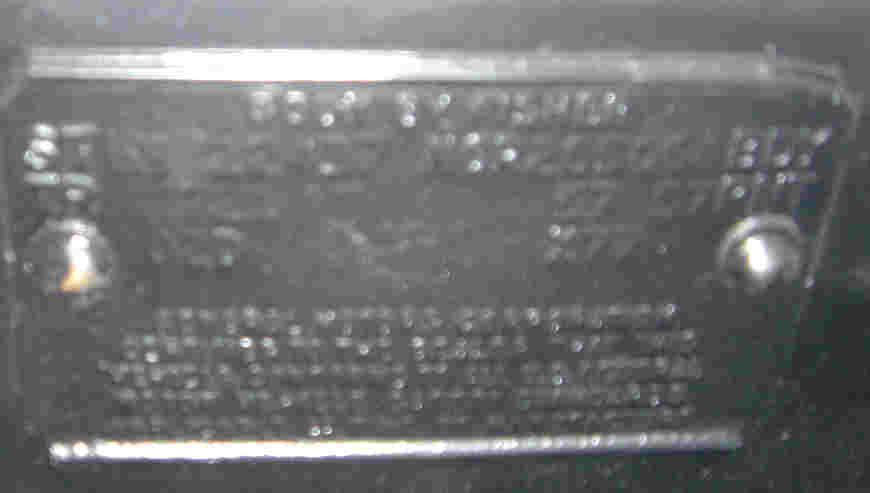

Picture of Cowl Tag.

Sorry for the bad reduced picture of cowl tag.
12437 NOR 265068
TR 721 57 57 PNT (Green with Green interior)
02D X77

Ok, I am answering my own questions here. I would like to be correct in my thinking.
The date on the cowl tag is 4th week of Feb.

Need a better pic of the trim tag. What is the VIN?

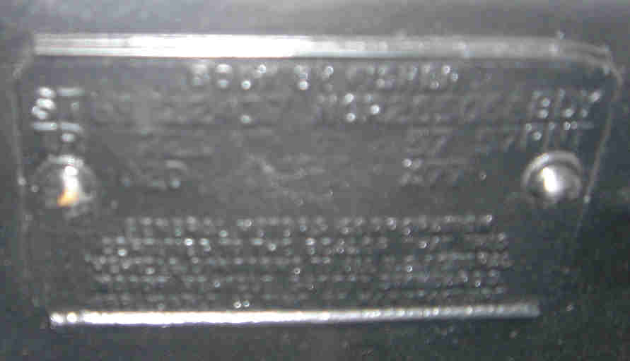

Here is a better picture of the cowl tag. Hopefully it is a better picture.
I have not looked for the vin near the oil filter yet. I am going to look at it on a hoist now. It was on the ground when I looked at it. I took a few pictures but I forgot to take one of the VIN.
