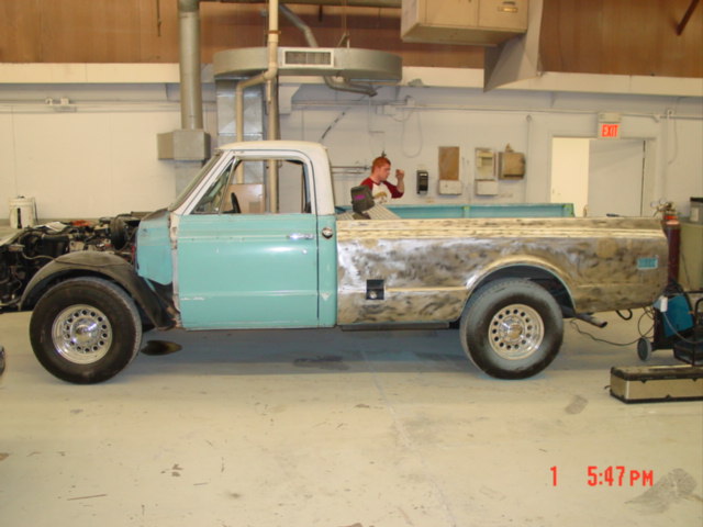

here's something
i just had my 69 350 rebuilt,i had to remove the drivers side head to seal the small plug on the block.
and the rear main leaks too.
i think i got screwed,check out this oil puddle
