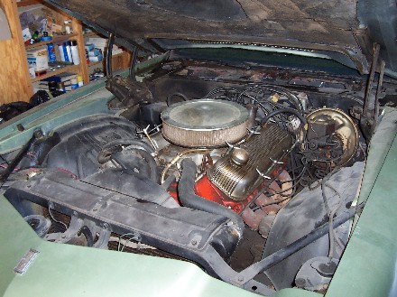

and the engine. The original exhaust manifolds come with the car.
