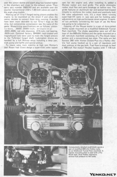

This photo is in the B/M photo gallery--you can enlarge it--
Old 12-13-2005, 12:32 PM
musclcar musclcar is offline
Join Date: Feb 2003
Location: signal hill calif.
Posts: 381
Default Re: day2 tunnel ram fuel line
that motion small block pic is almost like my set-up i'm running the offenhauser push/pull linkage for side mounted holley 660's.i also have the holley heat shields under both carbs just like in the pic.i finally found a older moroso cool can that i'm going to mount were the battery used to be.from there i'm running 3/8th fuel line to a moroso fuel block then split to each carb.i'm going to just drape the fuel line like the yellow day 2 69 camaro
