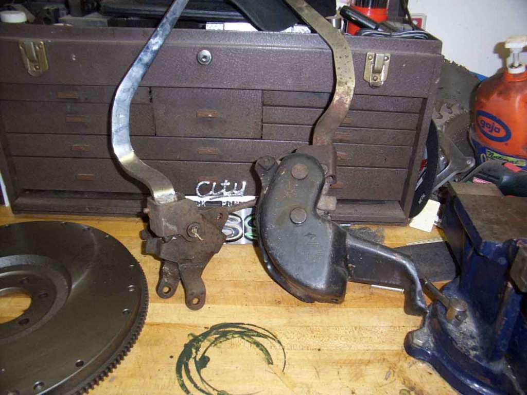

Over the years, there have been rumors that a few early 67 Z28 cars didn't have Muncie on the handle. As many of us know, a plain handle was intalled with a Saginaw transmission. I've been asked to restore a shifter from a late Dec. 1966 car that doesn't say Muncie. The shifter and linkage are indeed small block OEM Muncie.
Anyone ever seen a unmolested example of this?
Thanks for knowlegable replys Gents.

I've seen the large 'T' at the base of Muncie 4 and 3 speeds, Saginaw 4 and 3 speeds from 1967-69 handles. They are random and don't seem to relate to any particular year.
So my question remains: Anyone have a unmolested example of a early 67 plain handle factory installed on a Muncie Tranny?
Early Z28 guys - please chime in.

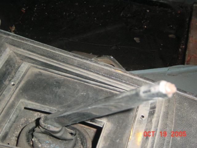

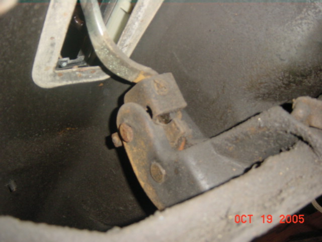

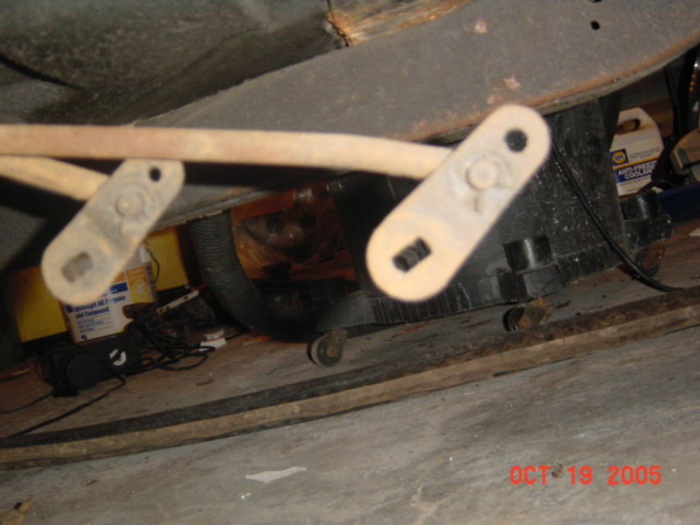

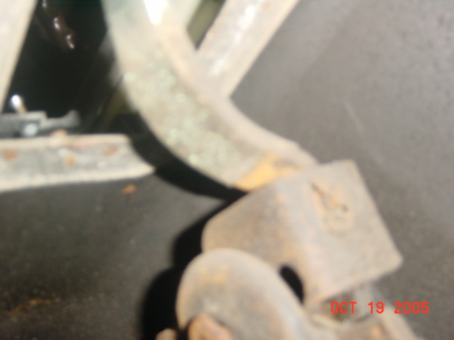

I dont consider my 67 z/28 an early car because it is a May car, but My shifter is what appears to be original and does not have the muncie on it. It is possible it was replaced, but the car has 19,000 miles and hasnt seen the road since about 1976. I'll try to take pics of it. It is still in the car.
Pictures would be very helpful Mike. Please post them if you can. Thanks for the effort - we all can learn something on this subject.
