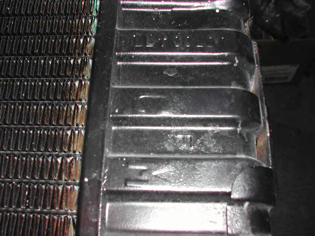

On a 68 big block nova the radiator has a code of CM with a little "F" in the middle on the tank. Anybody have the codes for a nova?

CM Suffix code callout is for radiator part #3012411 for a 1967 Big Passenger Car 396 or 427,non Heavy Duty,first design,non A/C,for a Manual Trans.application.

That's the tank code which would have been stamped next to the application code (which Rick mistakenly assumed you were referring to) on the rad tag. Small letter is the date code. http://www.camaros.org/coolingsystems.shtml
Don't recognize that tank code, but I don't know Novas.

Sorry about that Jeff,I didn't notice you attached a picture of the Tank showing the embossed code.

It has a 4 core in it now, it looks new. Does anybody know what the 68 Gibb novas came with?
2.70 4 row with IL code on the Gibb Novas

What is the two letter code stamped in the tank?

The bigger tank has C H with a small E stamped on it. The smaller tank has I L on it. Kim

As Kim has posted, IL & CEH. IL is on the drivers side & CEH on the passenger side.
