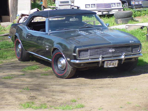

My 68 has the steel wheels with the 4 piston caliper disc brakes.the code is XF.
Les Dixon 68 camaro SS 396 RS convertible L34/M40/G80/U69

Sharp looking 68 SS/RS ragtop Lester. I think the steel wheels with the caps add alot to the appearance. Love the color too!
Tony

Thanks MR.T for the kind comment.A lot of people tell me to put the rally rims on it, but these are the original rims and for some reason I just love the way the standard hub caps look. And as it turns out, they are fairly rare with disc brakes.
