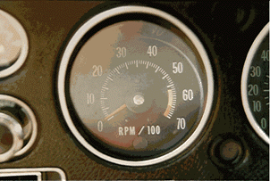

My friend has a 70 SS Chevelle that is suppose to be a LS-6 454 car .We do not have the motor but the car is complete other than that.How can we tell if it is an LS-6 car for shore.
Yenko el

For starters, if the car has factory gauges, see if it has a 6,500 rpm redline tach.
This is also assuming it has its original dashboard.

It does not have the factory tach and has idiot lights for gauges,It has the turbo 400 trans.tomorrow I will get the vin # for help.
