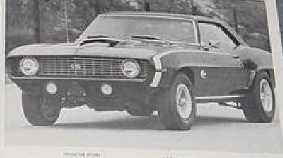

I'm in the process of restoring my 69 BM Camaro and wanted to solicit some opinions on tires. For wheels I will be using Crager SS.

Is this the tire look you are going for?
Pro Trac has a repro tire on thier site p235/60-15 that is 27x10x15. This may be the closest you can get to the old Ingelwoods but I am not sure of all tires that are available today. Joel used to roll in the inner edge of the q-panel to get more clearance. Funny thing on my 87 Motion Monte SS, Joel put wide 16" wheels and he rolled in the wheelwell. He built cars the same way for over 30 yrs [img]/ubbthreads/images/graemlins/biggthumpup.gif[/img]
